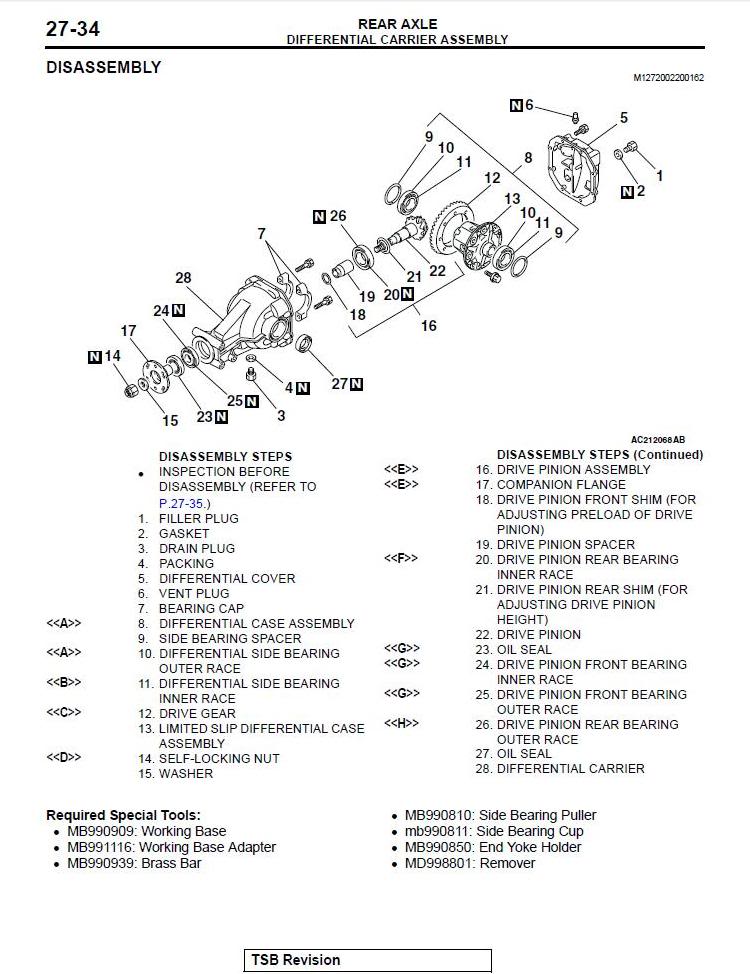

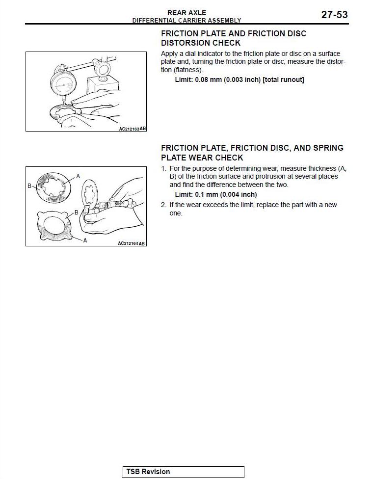

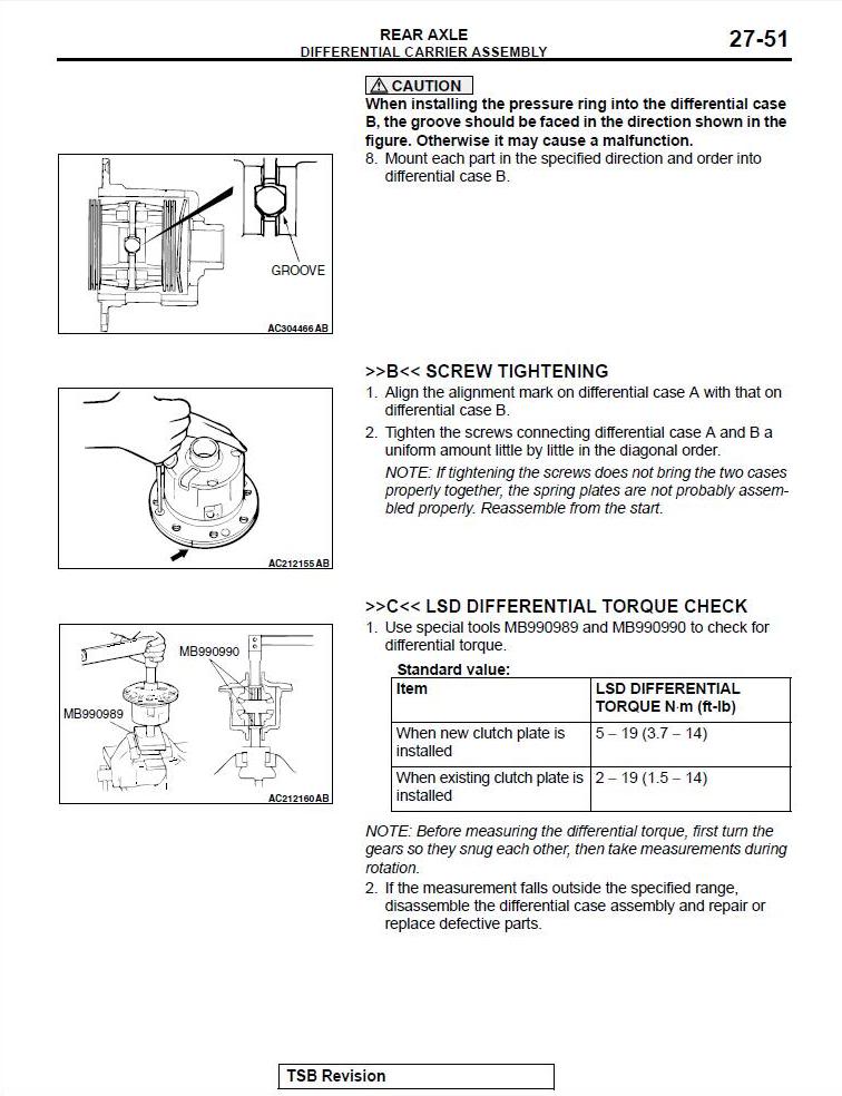

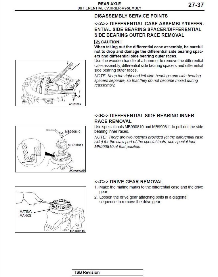

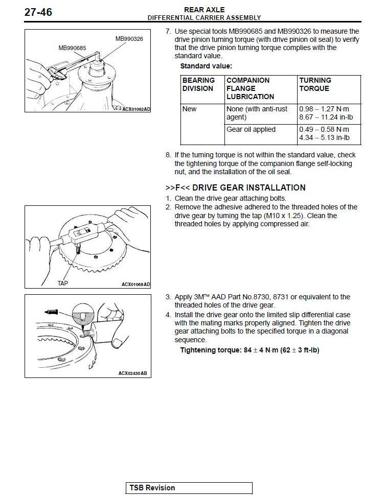

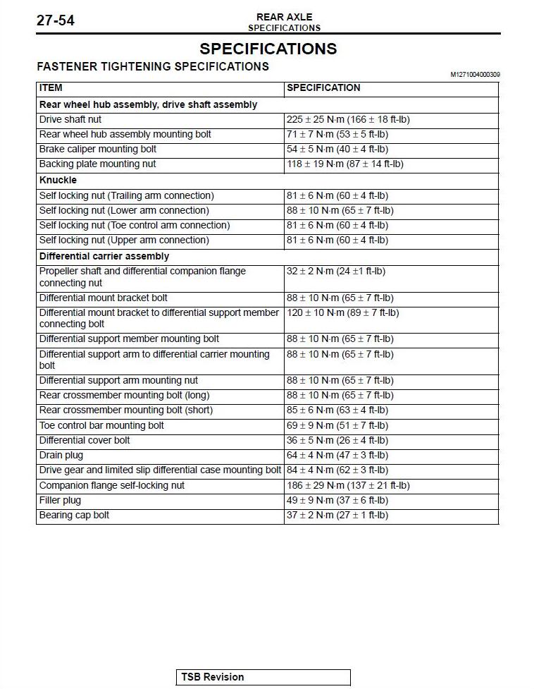

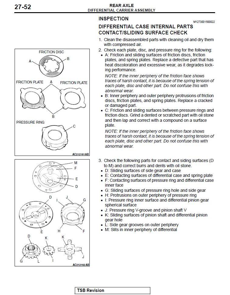

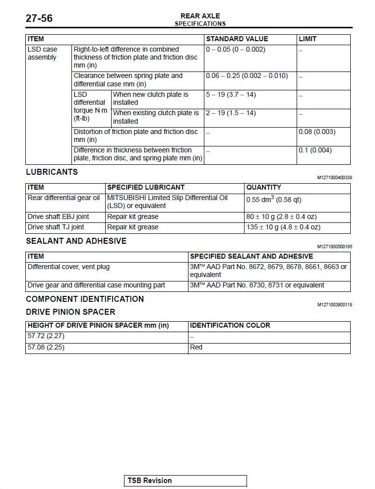

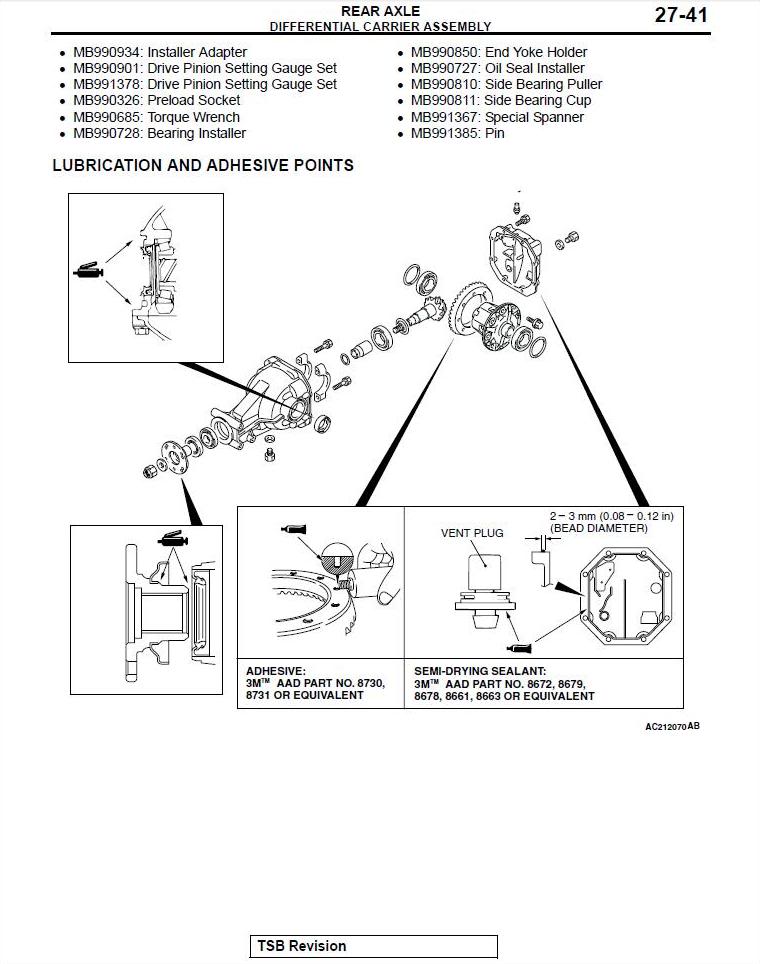

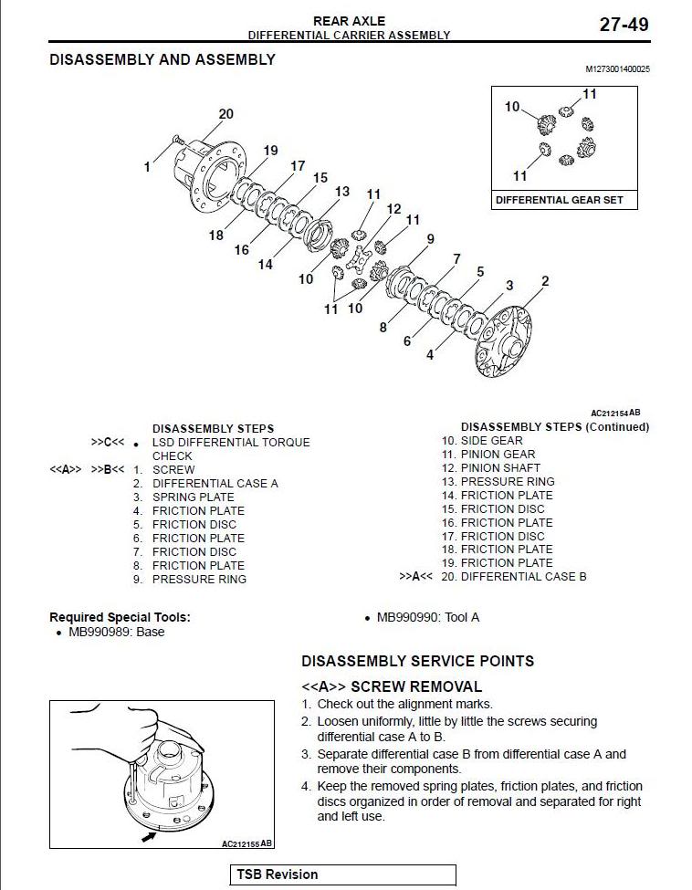

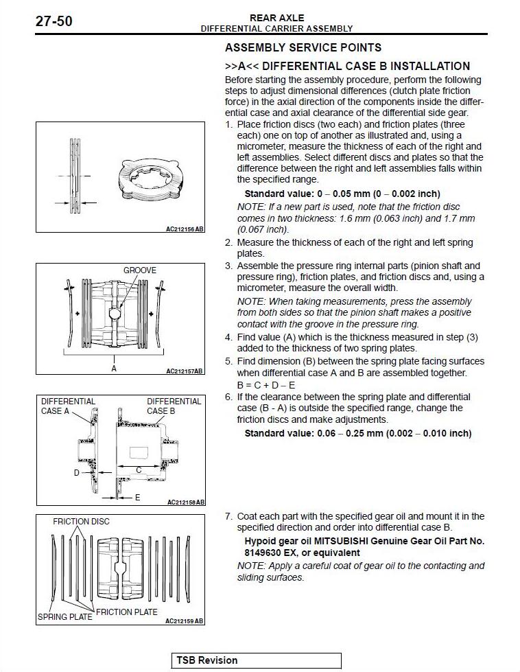

Here's some info if you want to perform this yourself. Following the service manual, will double the friction surface.
You'll want to have a gear/bearing puller, torque wrench, metric sockets, specified thread locking compound, sealant for the diff cover, having a dial indicator to check backlash while you're in there wouldn't hurt either.
When you open the diff and clean everything off, you'll be able to see if the ring and pinion are meshing properly by the wear marks on the teeth, the marks should be very close to center. If this is good (as well as backlash), all you need to do is disassemble, reassemble plates in correct order, torque everything down using the specified thread locking compound and seal the diff up again. Don't forget to fill it back up with gear oil.
Tip: Jack up the rear of the car to allow extra LSD fluid to be added w/o it running out of the fill plug.

i really have to suggest to those looking to "do it themselves" to just send it to TRE. jon@tre is a total pro when it comes to this kind of thing and he does a lot of little extra things that make the diff come together.. i really dont think its about just stuffing 12 plates into the diff so that it'll fit and work
Old Jun 22, 2011 | 03:49 PM
  #615
EVO8emUp's Avatar
iTrader: (30)
Posts: 1,228
From: Wheeling, WV
I'm not discounting Team Rip at all. They go over the whole diff, add new plates shot peen, new bearings and also have some nice heavy duty side cover options, rear cover with sight glass and filler relocated.
You're making it should like by following the service manual to install the plates correctly you're just guessing and blindly slapping it back together.
