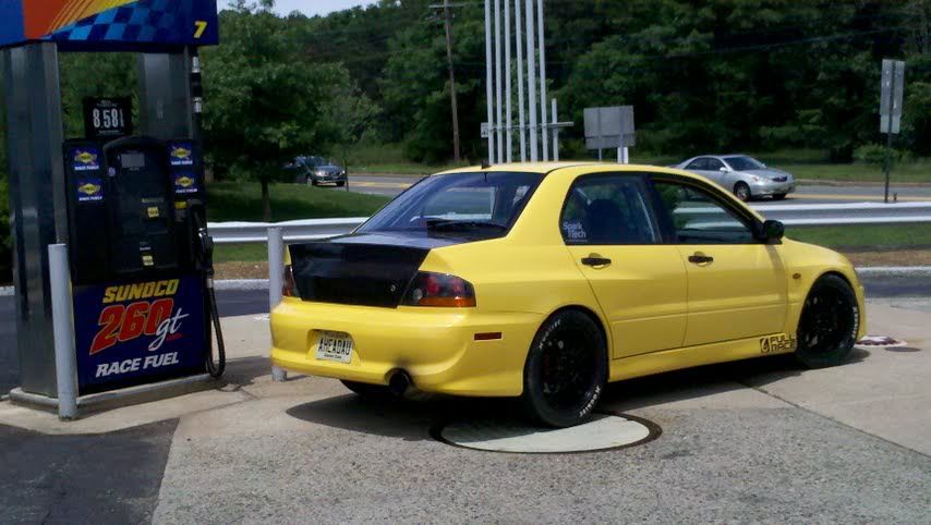

here is some pics.

Originally Posted by evodan2004
here is some pics.
Sexy pic!!! That burnt mark is such a nice touch...
Also, sits nice man, the wheels came out good...
As for the ignition issue. Thats boggling. You changed the plugs, ignition, and lowered boost to still have problems. Interesting. Can you post up whatever it is that solves the problem, would like to know for knowledge sake.

Hey Dan that sux about the mis-fire issues!
I must say that the car is looking DAMN GOOD though
I like the hood, trunk, and wheels together very nice man.

Car looks great man! Keep us updated on the misfire issue. I need to lower my front end more like yours, looks real good, but sucks because I already scrap on stuff with my SE lip...
