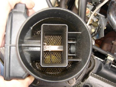

Today I ran across a car which was not running properly, it was running overly rich for the mods it had and no amount of tuning coulkd correct the imabalance
After a while I thought to check the MAF sensor to see if it had any contamination which could be effecting the reading

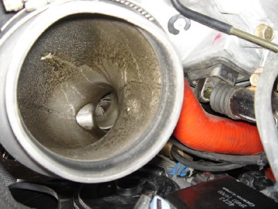

What I discovered was that large amounts of dirt had been getting through the HKS RS foam filter and the intake tube and MAF sensor both were caked with dirt and oil
This car had 26,000 miles

The MAF sensor

HKS RS is known for bad filtration. It lets thru a lot of air but also a lot of debris. I think keeping the stock airbox with a drop in filter is the best idea especially if you occasionally do some rally driving.

The filter picks up the small stuff but the sand goes right through.
Just change the oil more often, the crankcase is where it all ends up in the end. The thought of the crud hittling the blades of the turbo worries me though.

Keep in mind for what its worth that this car was being tuned in LA which has a lot of dust
I would prefer a K & N style cone filter such as the Buschur, Injen, AMS, Helix, etc
The HKS RS makes great power but is not good in dusty loactions

HKS has several types of filter elements that fit the RS mushroom head.
There's the green type which comes with an HKS "Super Power Flow" filters a lot more than the yellow stuff that comes with the "Racing Suction Kit" - or the RS kit. The yellow stuff filters out insects and perhaps rocks.
Just to make things complicated, they do dry type also and they come in all sorts of colours. There's the 2-layer type and a 3-layer type. I actually have a 3 layer filter for my Subaru, but haven't installed it yet having found out the hard way that the yellow stuff doesn't actually filter. (I'm running stock intake on the subie at the moment).

This car had the yellow one
I am starting to see more and more MAF sensors getting oiled and dirty on evos
Perhaps a oil catch can could also help
