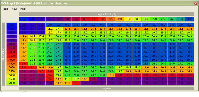

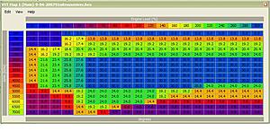

currently using this map with no knock at WOT (not yet tested on track) - AFR between 11 redline and 12.5
any idea on possible improvement in the 6000-7500 area?

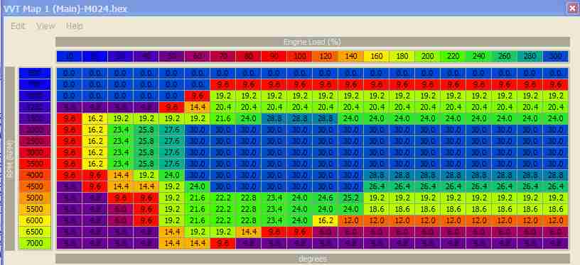

Here's the map I made from 3 maps I have tried. Thanks to the first poster for the mivec early advance idea! I found alot of knock with your advance in the 5000 rpm + and 200 + load areas. So I reduced the advance to the RS map spec in those areas. So far this one seems good. The spool up is much improved over the stock map and the JDM RS maps, better by 500 to 1000 rpm

With that much advance down low (below 100 load), don't be surprised if you get a CEL for too much intake cam advance (P0011).
I have been running a map similar to this (I posted it in this thread) for a long long time and I have yet to get a CEL. I have three other Evo 9s running the same map and not one of them have triggered the P0011 code.
Try my map on the cars that you are tuning and your customers will be blown away by the low end pull on this map.

Using more aggressive MIVEC timing down low, I've seen two cars throw the P0011 code. One kept throwing it right away (within 10 minutes of driving), and the other took nearly 4 months to trigger. It seems that some cars are just more sensitive to this type of advance. (Yes, I verified that the CAS sensors were installed properly on both cars and that the valve timing was properly set.)

NJ, thanks for the first part of my map. I did rip it off from your post. The last part is just the jdm mivec. It seems to run best without knock for me. I have not got any codes from this mod yet. The car runs better than it ever has with this map. I wonder if negative numbers can retard the cam for high rpm??
