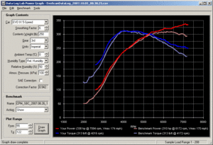

SC, do you have a log from before that map to see what increases were made where?
Old Oct 5, 2007 | 12:10 PM
  #345
recompile's Avatar
iTrader: (38)
Joined: Nov 2006
Posts: 1,745
Likes: 10
From: New Hampshire, USA
