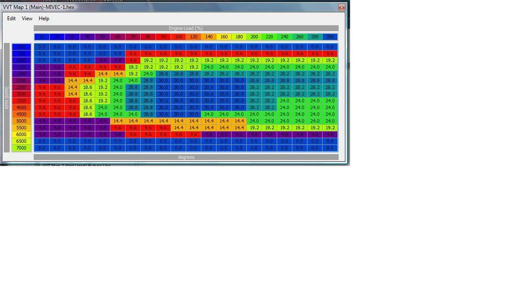

I made this map and works good.
Old Oct 30, 2007 | 09:36 PM

Nothing better to do .. so did a load test .. this is the result ..
0 degrees
15 degrees
30 degrees
more or less agrees with the others that tested ..
Full advance up to around 6000
6000-7000rpms taper to 15
0 advance above 7500rpms

so your saying you can have 30 in the maps all the way up to 6,000 RPM?
Old Nov 1, 2007 | 03:53 PM
  #390
gunzo's Avatar
Joined: Oct 2002
Posts: 1,328
From: Somewhere
Originally Posted by fastrob691
So have you combined all three and done another load test, and which is which one the test(30 is highest load at lowend, etc.) I am guessing thats it but clarify some please.
didn't have that load test overlayed on this if that's what you're asking .. but yes, overall that was what I had .. combined the 3 and use the result ..
Yes .. that's what my car likes .. and it seems consistent with what the others have .. except for exactly when the cams should start retarding
