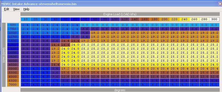

Getting a P0011 code on my 06 EVO IX and thought I would post the MIVEC tables from my tuner here to see if anyone thinks they're off. My builder has gone through timing twice and is about to do it again, tested many mechanical and electrical aspects of the system and even installed a brand new MIVEC gear.
My tuner assures me that the tune is on point and the issue must be mechanical.

Are you able to log mivec? If so what are the results of the tune?
You can also test the OCV to make sure it's functioning.
Search for the information for both, it's all on here.

What's your exhaust setup? You might have too much in the midrange - high end

I haven't tried to log MIVEC, I'm going to try and figure that out with Evoscan this weekend if I have time.
Tested the OCV and it's functioning properly, even swapped it with a for sure known good one off a IX with the similar set up and still got the code on my car.

p0011 is for mivec slow to respond , check filter in the mivec oil feed fitting that the banjo screws into , bad idle will also throw that code

I would try zeroing out the cells with the 2.4 which are in the idle zone.

Hmmm.... I recently learned that when you have a dump pipe you need less advance after like 6000
