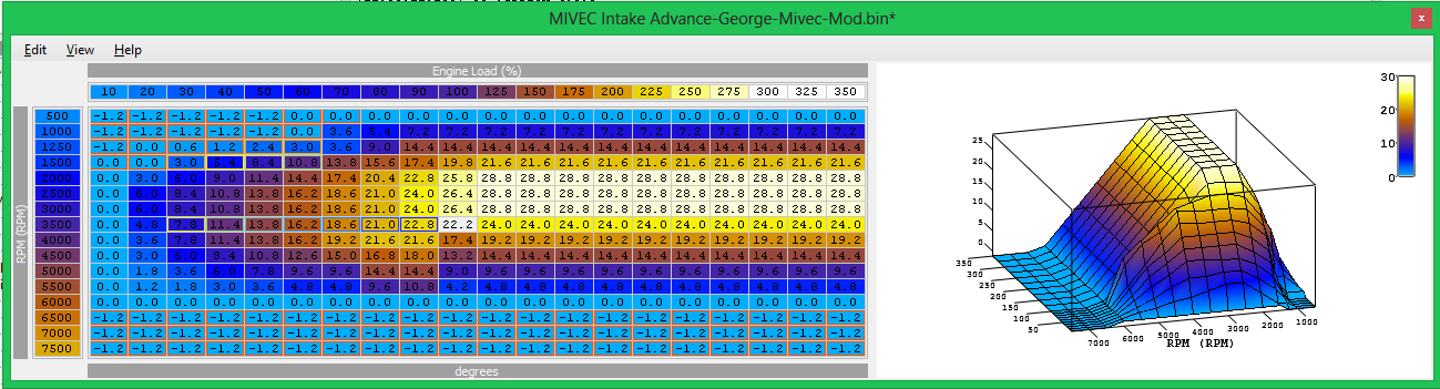

Here's what i came up with after Reading a lot of theory about Valve Timing and taking into consideration my Kelford 272 cams.
Ill Explain from what i have learned. This is THEORY, NOT fact.
Valve Train overlap:
  • Valve overlap doesn't work out so well for boosted engines.
  • We don't take advantage of the scavenging effects that a Naturally Aspirated engine does.
  • When there's valve over lap the exhaust is cooled slightly witch increases spool up time.
Effects of Advanced Intake Timing:
  • Valves Close at BDC
  • Good for low RPMS
  • Bad For Spool
  • Use in Low RPM High Boost
  • Use Everywhere in very low rpm where turbo won't spool anyway.
Effects of Retarded Intake Timing:
  • Valves close after BDC (so the charge continues to flow into the chamber via momentum)
  • good for High RPM
  • Good For Spool Up
  • use in low-mid RPM to spool Turbo
What MrFred said sounds like some awesome theory to me, that the exhaust manifold back pressure being equal to or greater than the boost pressure is a bad scenario for valve overlap. So my stock turbo with its small turbine is going to equate to a High manifold pressure. I made sure to have my intake timing is as retarded as possible by redline. I am going -1.2, not sure if it really goes that low but since were supposed to have 30* of travel out of Mivec and it tops out at 28.8* i am assuming that the extra 1.2* is comming off the backend on the negative side hence -1.2*.

Try logging mivec
