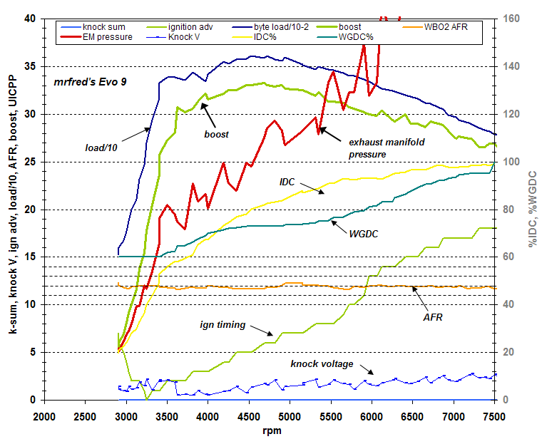

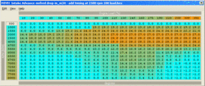

Nice post. My current 2 cents on MIVEC intake in the high power part of the map is that the appropriate amount of MIVEC intake advance depends on the ratio of intake pressure to exhaust gas pressure. When the exhaust gas pressure starts exceeding the intake pressure, reversion is a certainty, and the least amount of overlap is best. I think people have understood this for a while, but perhaps what people haven't recognized is how high the exhaust gas pressure can get.
Check out the attached plot of exhaust manifold pressure (EMP) vs boost pressure for my BBK pushed to the limit on E85. The ratio of boost to EMP is 2:1 at 3500 rpm, but EMP rises very rapidly and matches boost pressure by 5500 rpm. By 7500 rpm, the ratio is ~1:2 (very unfavorable and a bad place to be for extended periods of time). In my estimation, overlap should be minimal by 5500 rpm (MIVEC set to zero). My current MIVEC map is also attached, and apparently, I'm not quite listening to my own assessment because I still have some advance at 5500 rpm. But I'm pretty close, and next time I'm on the dyno, I plan to investigate this a little more. Also, notice that lower load range of the MIVEC map, I begin to add back MIVEC on the assumption that the ratio of boost to EMP starts to become favorable. I haven't done any low boost pulls to verify the ratio though. Its another thing I need to investigate........
Most people wrapping out a stock turbo or any of the stock frame turbos on E85 and max boost are probably in the same boat, and I suggest experimenting with zeroing out MIVEC after about 5500 rpm for best power. Comments are welcome (and inevitable).
