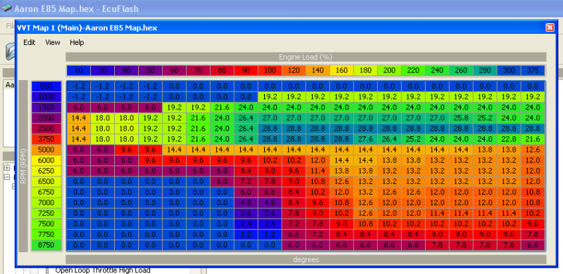

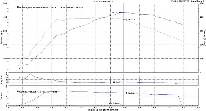

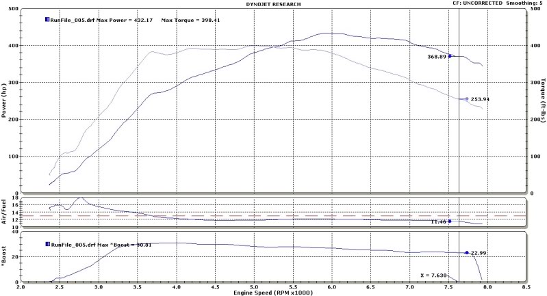

Originally Posted by recompile
It's not really possible to hold 24psi @ 7000RPM on the stock turbo. 20-21 if you're lucky, but more likely is 18-19.
Are you going by a visual check of your boost gauge? Unfortunately that's not good enough. Logging via a 3 BAR MAP sensor will reveal the bad news to you.
I am holding 23 to 7600 with a MBC, verified by both my dyno and my JDM 3 bar Also please remember I have switched back to a stock turbo as well for the time being.
I will go get the log and the dyno screen print shortly as well as my S2 MIVEC.

From: Northwest
Originally Posted by lemmonhead
its a fact that more valve overlap means air enters as the exhuast is finishing leaving. NO theory its a FACT.
So if you start your combustion point to long, retard ignition timing, and the "flame is still burning" then this Heat can escape through the intake valve and that is where you meth is coming in.
What you are saying about overlap is 100% correct.
I am not quite following how the intake valve is opening before the exhaust valve on the exhaust stroke (how it reads to me anyway)? Positive pressure will still be pushing any flame front out the exhaust valve (not intake) and this is one cause of the increase in EGTs.
The other thing to keep in mind with MIVEC is where we are in comparison to an VIII on the table with a stock camshaft. If you compared the 2 the intake cam would open in the VIII roughly 19.2* advanced on the MIVEC table (this maybe subject to the 30* range of motion having a negative in the table value). It is for certain no less than 17* on the table as far as equivalent overlap however.
