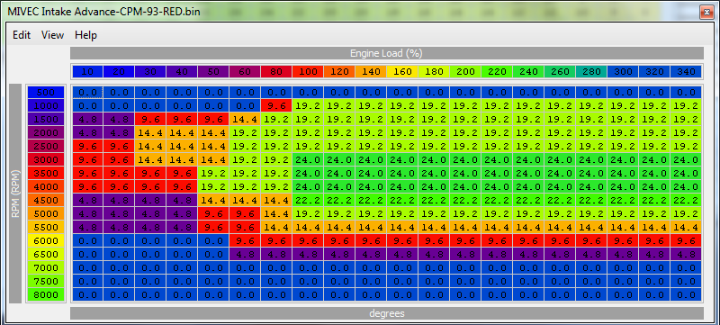

Any input on this map? I haven't had a chance to flash it on the car yet, waiting to get my wideband fixed.

Question : In tuning the MIVEC. Does it seem to be the best to have max MIVEC at peak torque, and then taper down. Basically following the load down as boost tapers off ?

It is measuring crank degrees of rotation. I think I posted the exact stats back in post 97ish or so.
Yes But actually a little prior to the actual torque value. Spool, decrease advance, profit.

FP 4R
FP Red holding 29psi from 3700 to redline
Old Jun 30, 2009 | 07:43 AM
  #583
MR Turco's Avatar
iTrader: (16)
Posts: 3,233
From: Massachusetts
Originally Posted by recompile
FP 4R
did you try advancing the cam timing even more?

I've been fiddling more with MIVEC at high boost. At first I thought that less MIVEC at high boost was beneficial, but after fiddling more, I'm getting best gains by keeping MIVEC maxed out at 28.8 deg until about 5K rpm even with 27 psi of boost and a relatively restrictive exhaust (stock O2 housing, 100 cell cat).
The thing that was concerning me is that there might be charge flow reversion if the intake was opened too soon because of high residual pressure in the cylinder. In a datalog, this would show up as either no increase in load with more MIVEC or possibly even a decrease in load with more MIVEC (because load scales with airflow). However, even at 27 psi, I get higher loads as MIVEC is increased all the way up to 28.8 deg. Torque is better as well out to 5K rpm. Out past 5K rpm, I need to do more testing to figure out what is working best.
