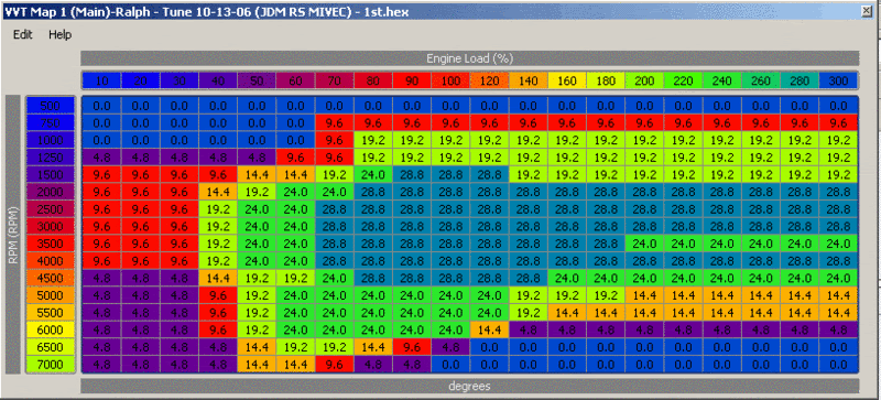

Not that its alot but I've made about 15 dyno runs testing various mivec maps and I've always witnessed my best results by not shaving mivec timing off in the upper RPM. This is stock cam, stock turbo, stock O2, with only 3" TBE.
Some of you have gone almost a full circle on this mivec stuff.... Quite a few people are posting maps that look like only slightly tweaked JDM RS maps! (BELOW)
