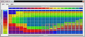

I've finally gotten into adjusting my MIVEC map. Here's what I've got so far.

Old Dec 9, 2013 | 09:06 AM
  #786
JohnBradley's Avatar
iTrader: (30)
Posts: 11,406
Likes: 78
From: Northwest
Since you are using my style of map already, at 8250 set the advance to -1.2* from 145* load and up, drop the advance at 5000 from 14.4 to 9.0, then interpolate that whole block.

Originally Posted by MRadjahoe
No but I gained 45whp in the mid range and 30whp up top with 2psi less boost.
Thank for the info!
Old Dec 10, 2013 | 05:05 AM
  #788
evo10.5t's Avatar
Joined: Nov 2011
Posts: 42
From: East Coast
John Bradley is this map for stock cams only or can it be used with almost any cam?

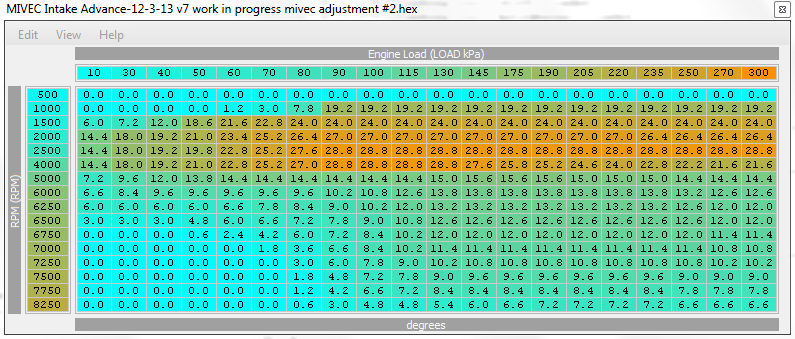

Hey Aaron, originally this was your map that you put in 4 years ago. I've been playing with it a bit. I was thinking of e-mailing you, but I know you're super busy. Hows this look? I won't get to test it for a while since the snows started.
Almost any cam as the centerlines typically are very close on most of them. Some of them need less advance sooner (i.e. Cossie), some can hold more longer and make more torque, etc.
Looks pretty close to what I would use, yeah.

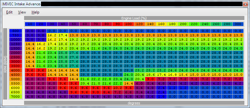

Resurrecting this, hope you don't mind
I went through the thread and produced an updated map for my car. This is a combination of some of the maps here as well as my original top end map.
This is what I'm running now and I can believe how much better daily driver the car is with this low end change only.
This is what I'm thinking of adding once I have changed my original catbat to a less restrictive 3" catback with 3" DP and stock cat.
Thoughts so far?
Old Oct 1, 2014 | 08:07 AM
  #795
mrfred's Avatar
iTrader: (50)
Posts: 9,675
Likes: 132
For a less restrictive exhaust, more overlap is better out in the high load cells. But don't go crazy with the overlap. What's shown in the first table is probably fairly appropriate. It will depend also on what turbo is being used.
