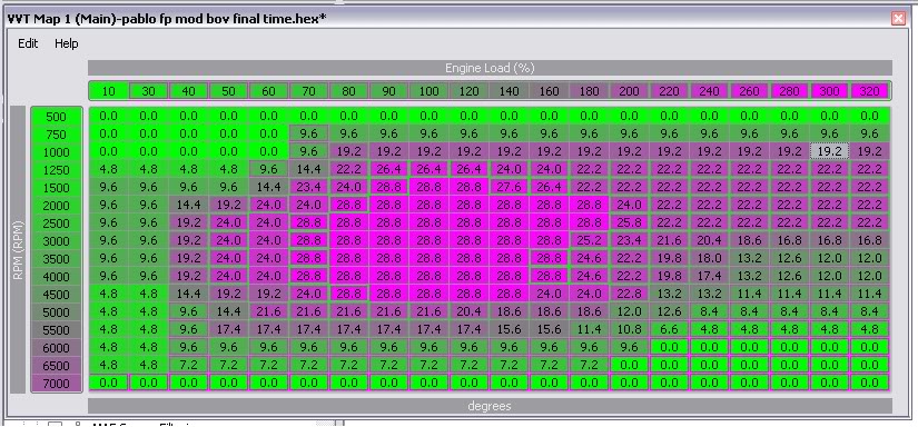

need a little advice on my mivec map from the more experienced...I'm running Kelford 264's on the stock turbo with meth at 29psi. So far with the help of a fellow evoM member this is what I've come up with:
From what I have gathered, tapering the timing as it approaches peak tq is best and also in the high rpm area.
If anyone else running the Kelford 264's with stock turbo is willing to share their map that would be great.
Old Aug 8, 2009 | 12:22 PM
  #592
rolly1818's Avatar
Registered User
Joined: Nov 2007
Posts: 1,507
From: Trinidad
mivec tuning is really ur setup.
i recently had Johnbradley's map on my car, off boost drivability - the car was awesome!
i was able to push a lot more timing.
then i switched to another map and had to pull timing but the car felt good. the car feel lazy off boost though.
i am currently trying different Mivec maps - but no dyno
NOTE: these were on stock cams and stock turbo.
i think i am gonna work on developing one for a off and on boost i will keep u guys posted. for now i would love some member feedback on what to look for.
