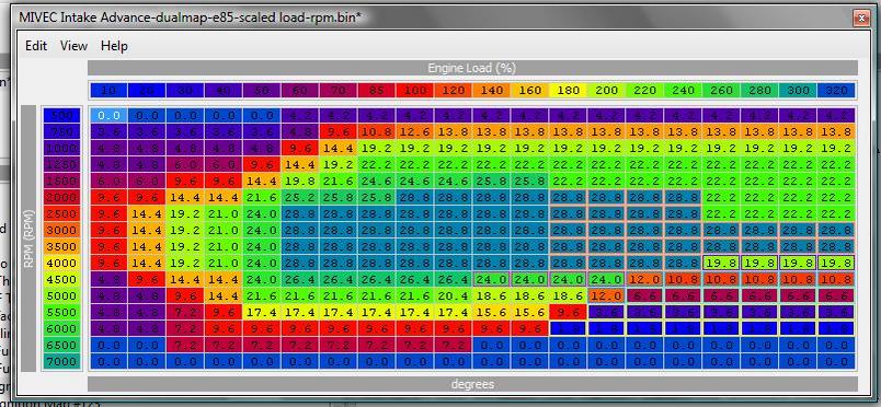

MrFred- something like this maybe?

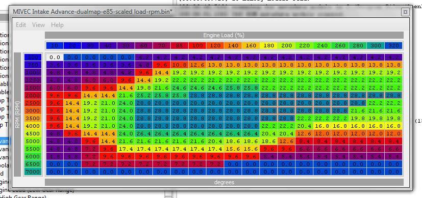

Or this?

Yeah, something more like the second one where you made the transition away from 28.8 a little more gradual at low rpm and then taking away more at the higher rpm. When I think about it a bit, the 28.8 values at 2000 rpm and 300-320 load are meaningless though because I'm pretty sure no one ever sees that combination of load and rpm. It might be instructive to put a map trace line on your MIVEC map to create an operating envelope, and then see if the changes that you made can ever be encountered.

With that second map, I would be hitting about 18-19 degrees at full load and then going down. I guess the question is - How much mivec advance do you want at full load? Do you think I should taper even more at higher rpm?

I'd try 28.8 in the cells encountered on the ramp to full load and then in the first cell at full load. Yes, I'd experiment with tapering even more in the traverse at the really high loads and rpms where the turbo is getting pretty far out of its efficiency range. You'll need to be very consistent in your "road dyno" runs to figure out what works best.

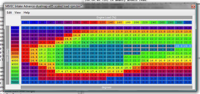

So in theory I would want 28.8 to 4k to 320 load. After that it needs to die down, and fast. The mivec stops completely at 6k correct? So I have 2k rpm to wind it down from 28.8 to almost nothing. It seems as if the timing gaps would be huge with this rapid decel. Would that be OK?

There would be no gap or "steps". The ECU interpolates when its between cell points.

I think this may work well.

That would be an interesting one to try.
