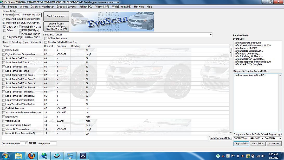

Hey everyone, I'm getting really frustrated here. I'm trying to scan my DTC codes. I have a tactrix 2.0 cable, the latest evoscan/ecuflash, 2004 Evo RS. I tried to fiddle with the settings, but I always get "No response from vehicle ECU". Last time I tried to fiddle with it, I hit "clear DTCs" to see if that worked, and it did. I also tried scantech, and it won't even initialize.
My original problem is that I had a rough idle. It would go full lean and sound like it's about to stall, then rev up to 1200rpm and go full rich, and bounce back and forth.
Anyways, any help would be appreciated.
Little update from above. Did a boost leak check, and found all kinds of leaks. I was procrastinating about doing it, but now wish I did it earlier. Anyways, fixed those leaks, and I found when I set evoscan to MUTIII, everything work except for DTCs. I just can't read those with any program so far it seems. I tried a generic handheld reader, and it just displays "ERROR".
