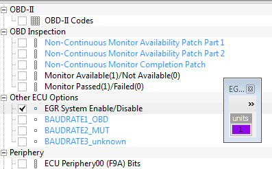

Hi, i own an evo 7 with teprha mod v7
How do i disable the egr??
My egr was removed long time ago before i reflash my ecu, so i didnt have that problem of check engine for egr
After we tune the car it appear the check engine light. Then i scan the car and it says code P0400 Exhaust Gas Recirculation Flow Malfunction
thanks
thanks
Find this section in your V7 ROM and change the 1 to 0
Attached Thumbnails ECUFlash / Evoscan / Mitsulogger Questions-capture.png
thanks
