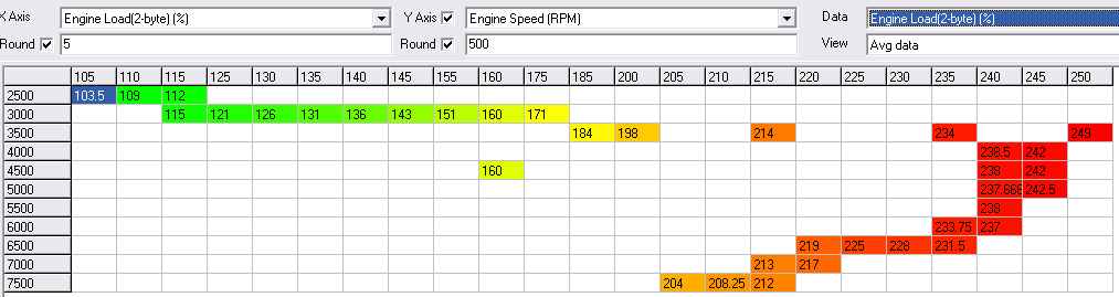

Buschur 3" exhaust with high flow cat
272I/264E GSC cams
Walbro 255lph Fuel Pump
Hallman MBC
Weapon R engine stabilizer
I didn't log the 2-byte load on this run, but it's running around 230 and tapers near redline.

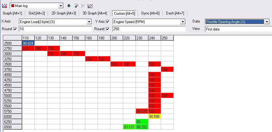

This is a log I did using Al's ROM. This is just to show the Load. Since I'm using a MBC this shouldn't change much with the tune. It doesn't show any of the tuning info. The values in the cells are the throttle positions. Load is the X axis and RPM is the Y axis.

What I would try is to throw some race gas with your map that has only the 6 counts of knock and see if it goes away. If it does go away, then it is tune related of course.

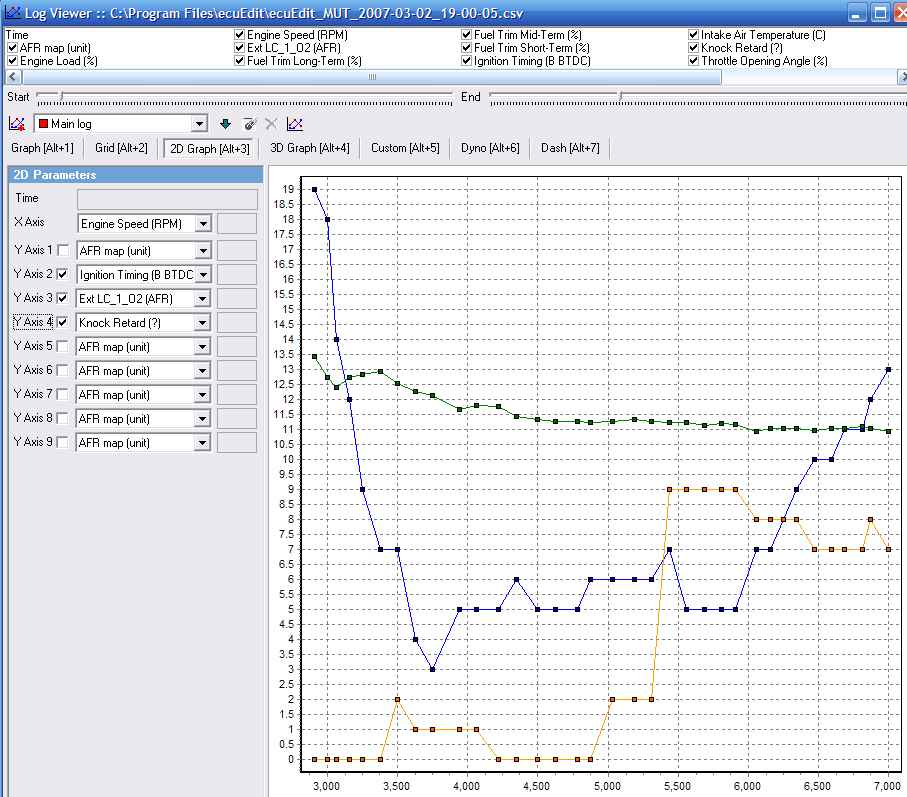

From the looks of the log, it appears that you have a jump in your timing map from 5 degrees to 10 degrees somewhere around 5500 RPM.
That's the point where you go from 2 counts of knock to 9 counts of knock. Maybe smooth that transition a little bit.

Looks like excessive timing to me as well. 7* in peak boost is too much and it's hard to tell what it tranistions too when your knock counts get high but your carrying knock through your entire powerband. What boost and what fuel are you running. Flash it with the stock map and log that or post your timing map so we can see what's going on.

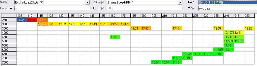

From the posted log, i see knock counts of 1-3 above 5500. I would back out the timing 1 degree from 5700 to the top in the appropriate load cells.
I would also run repeated pulls back to back without cooling down like 5 or six 1-4 gear WOT. Then check the knock counts on the last pull. If you get much more i would look at the fuel a little.
Most people would say you are running a little lean, but 11- 11.3 above 5500 seems OK as long as the timing is in check.
Just to be sure you might replace the fuel filter.
