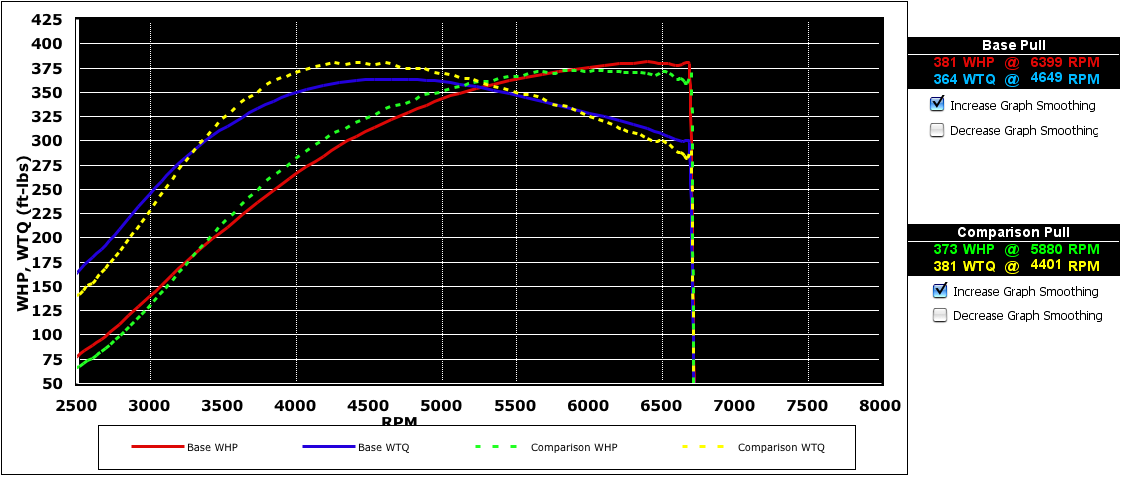

Question to anyone who has Excel AND openoffice.....when I open up the spreadsheet in excel (version 4.1) my torque values are elevated but when I open the SAME logs in OpenOffice, the peak torque values reflect my actual torque numbers from the dyno much more realistically. Can anyone else confirm a variance between the two programs for me????

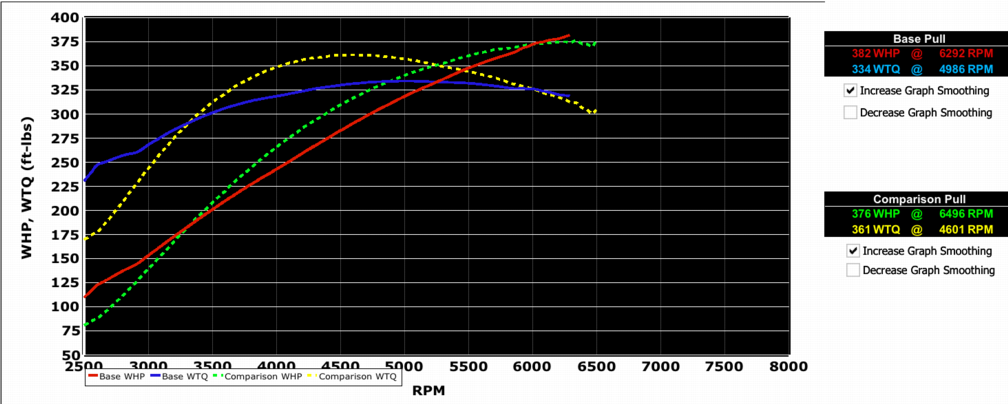

I have both on a Mac. HP is similar but torque is lower on Openoffice.
Attached Thumbnails calc HP/TQ from EvoScan using Excel-openoffice.png   calc HP/TQ from EvoScan using Excel-excel.png

Originally Posted by lan_evo_mr9
John, what chart settings are you using for openoffice?
I made a duplicate of the Excel file and opened it with Openoffice. The chart settings are identical:
Evo 8 3rd gear
3500lbs
Dynojet correction = 1.121
Air temp = 65
Baro = 30
