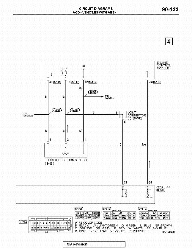

For meth - What ever you use to switch maps on not ICS cars (if that becomes a push button switch wired into the ECU) that same input could also be used by the meth failsafe. Most failsafes can give power or ground or complete a circuit on failsafe activation.
Any Idea's other than a switch of how you might switch maps on non ICS cars?

Well I was going to use the A/C button - but its not momentary
A possibility is :
* Car Off
* Ign ON
* Clutch IN
* Use and HOLD TPS to select map
* Clutch Out.
However that kind of pedal dance will get frustrating!
I guess if everyone is happy to wire in a momentary button then that could be the solution! However I suspect this wont be the case, and anyways utilising stock hardware is so much nicer
If the ACD switch was wired into the ECU then that would be perfect - but I'm 95% its not

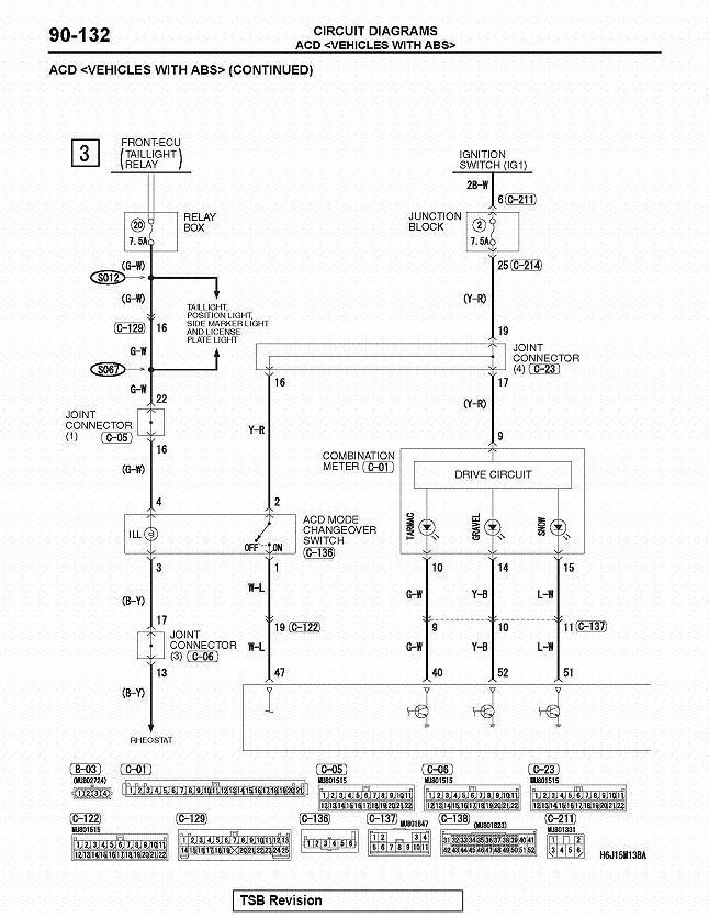

Well, I just took a look at the ACD wiring diagrams. The ACD switch is wired into the ACD ECU and three separate pins then control which state it is in (tarmac, gravel, snow).
However, the ACD ECU pin 36 is wired directly into the main ECU pin 79 and indirectly into pin 78. I'm no expert at reading these things, but maybe there is something that we can do with pin 79? Here are the two pages that I am referring to:
Eric

hrmm interesting - 79 might be worth looking at... let me check my disasm ..
Anyone want to open the ECU up to find out which port pin 79 is connected to?
