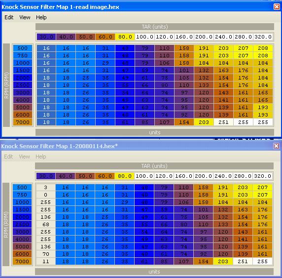

FWIW Here is my Knock Sensor Filter Map 1. The one on top was only modified by the Big A (the bro). I am pretty sure that he did not touch the knock sensor maps.
From what I remember, he was using TechTom and modifying from there. Although I did have a "basic flash" after having a "custom tune". From there he did a "custom tune" probably modifying the rom that he he used for the "basic flash". There may have been a P300 fix in the basic rom. I am not sure.
The one below is the v4.2 rom.
Both are 94170008 roms.

Take a look at this screen shot, as you can see the filters in 4.2 rom are shifted one column to the right compaired with my 94170008 rom. Top is mine, bottom is the 4.2 and matches several 94170008 roms I have seen.

mad_VIII - It almost looks like the definition is one value off for the table in your ROM.

Which has happened before, especially with the comfuscation that certain tuners do to the ECU's.
