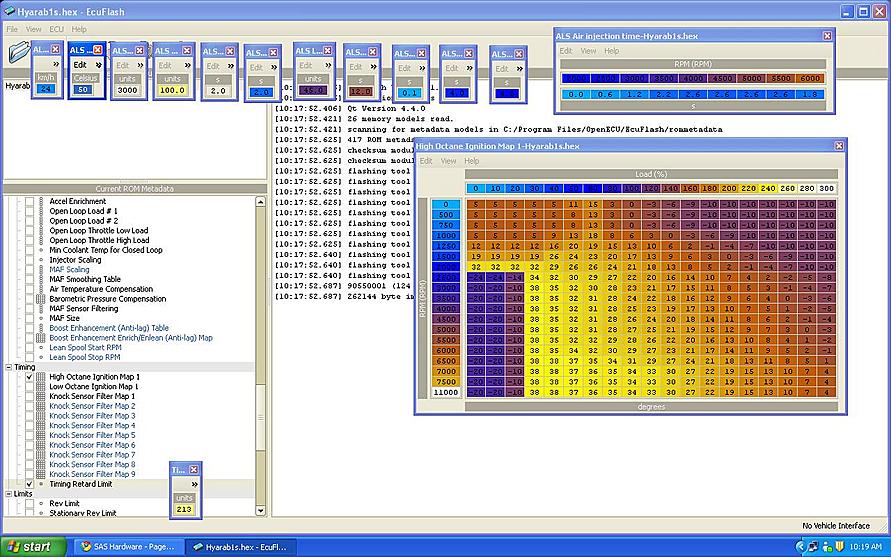

guys,i have jdm evo 7 with stock ALS hardware,i edited the tables in my tephra 90550001 rom and added negative timing,raised the timing retard limit to 213-255,i didnt get either pops or bangs from state rev limiter or ALS during runs anybody can help ?

did you alter the air injection timing also?
can you take a screen shot of your air injection settings along with your timing map...if it is the same style of map found here and geekmapped you are on the right track.
do you get a single pop or bang when accelerating hard and then letting off? Or do you just get nothing?

i did it the same style here and tried cossie1 air injection time still got nothing,
i have no bangs at all even single one between shifts,just rarely i can here pop on light cruising, i tried to log in evoscan timing i saw -10 one time on cruising.
hope anyone can help me.

If you can hear one pop on lift off after high load, means your air injection is working...
but to get the rest....timing is needed. I also see you posted on another forum about it. Those guys have way more experience about this than myself. You map looks about right, so it might just be a little tweak.
