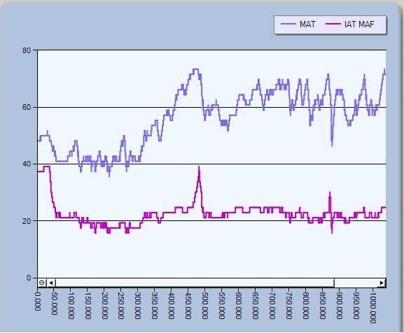

so i took a log on the way to work. This is over 17 minutes. I am only posting the IAT and MAT values but can post any addition parameters. The spike on IAT is a 2nd gear pull from 2500rpm to 7800rpm.
Looks like the MAT is consistently hotter then the IAT. And you can see what the outside air temp is - high today is 39*
for the record, i am running the perrin intake with the stock airbox snorkel in place to push colder air in. looks like it is working.

Interesting. That seems to coincide with about what Tephra is seeing with the sensor in the same location.
So, now we have at least two people with the sensor in the UICP (mrfred and I) who see roughly equal IAT/UICP-T while cruising whereas you and tephra see roughly 20-50F greater MAT while cruising.
All of us see rising post intercooler temps during a pull, as expected.
So the real question still stands...which is more representative of the true air temps going into the cylinder? Perhaps neither, and as 03whitegsr has stated, a correction table may be needed of some sort. I think the only way to tell for sure is to test the SD patch alongside a MAF, doing several pulls and cruising, calibrating AFRs from the SD data to the MAF data. That will tell us how much, if any correction is needed.
What I do find interesting in your plot above that may be pointing to some kind of heat soak/boundary layer/etc phenomenon is that your cruising temps seems to hover roughly 20F above IAT, yet after your pull, they seem to hover roughly 45F greater than IAT and seem a lot more choppy than before. You may have been doing a lot of on/off throttle driving here, so I don't know, but that's something to take into account.
I think this is all good data for the eventual SD patch.

I've been logging OEM JDM MAT for the last year or two on my Pocket PC, and have a live display as I drive. What I notice in particular is that IAT and MAT creep up at low cruise speeds, and they diverge. They converge again with more airflow through the intercooler and more throttle. MAT can even drop when you go WOT, and then rise again after the pull.
Some of these effects may be due to heatsink/heatsoak of intercooler/inlet manifold, and the relative effects of fresh, cool airflow compared with coolant or cylinder head heat flow. Some may be due to the large thermal mass of the large OEM sensor. However, it doesn't behave wildly differently to my old Subaru with FMIC and a very low mass fast acting K-type thermocouple just before the throttle body.

John, do you have a pic of what the JDM IAT sensor looks like? We were wondering if the tip is the same as the GM IAT.
Wreckleford, i have the hondata but only installed it when i installed the sensor so i don't have before and after. As of right now it looks like it isn't really doing anything which makes the only real advantage of having a reusable gasket. Then again i would like to get some logs in the same temp range as tephra and see if it does work.
I'd like to see a picture as well. The MAT sensor on the Evo X should be the same as the JDM Evo IX MAT sensor, so any pic of that would work too.
The IAT correction factor is an interesting concept. I like the idea, but I think there is the potential to get too carried away with it. At some point, there needs to be a division between manifold air temp and the temperature of the air in the "engine" (before compression and combustion). Do we really need to estimate/know the air temp at the end of the intake runner just before it enters the cylinder? What about the cooling effect of the fuel spray from the fuel injector?
One thing that surprises me a bit is how high the MAT temperatures are during cruise. I realize that significant amounts of heat pass from the head into the IM, but with the throttle butterfly mostly closed and a good vacuum in the IM, there should be a strong cooling effect on the air as it passes by the throttle butterfly. I'd really like to see someone get some MAT numbers before and after disconnecting the throttle body heater. Just don't do it in near freezing weather, or you'll likely freeze up the butterfly.

i can do this test in the future, but as you can see i fear something freezing. Then again, the throttle is mechanical so i am sure i could break it loose with my foot
Interesting data, I agree, it would be very interesting to see how a car looked with the EGR and TB coolant lines disconnected along with a intake heat spacer to see if they really did anything.
On a side note, is the spike in IAT during or after the WOT pull?
As for SD setup, I think this proves one important thing. When it comes down to it, it really doesn't matter where the sensor is located. Tons of good tuners put the IAT sensor in the UICP and just as many insist it needs to go in the manifold. All of the good tuners get good tunes regardless, because the reality of it is that the motor will operate in a given situation pretty predictably and you merely tune the main fuel map and compensation tables to make it work.
Maybe the actual intake temps are somewhere between the coolant temp and the iat, but as long as your fuel table provides the pulsewidth to get the fuel you need, it will work just fine. The only difference will be that the temp compensation tables will be slightly different between the different setups.
