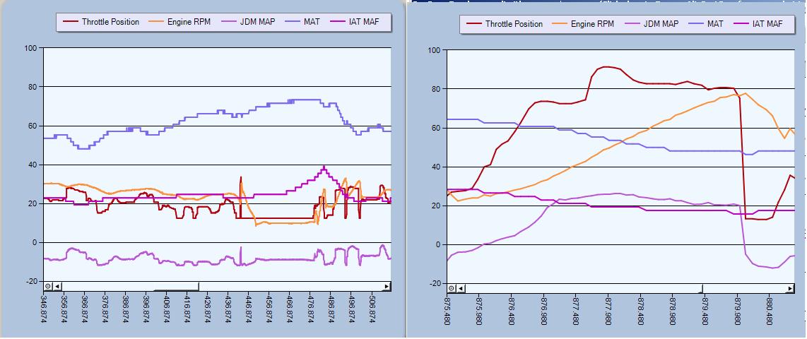

On a side note, is the spike in IAT during or after the WOT pull?
Actually after reviewing my logs I see some interesting data. Below is some highlighted areas of interest.
On the left the spike in IAT/MAT is from idle, which makes sense. On the right there is a drop in both IAT and MAT during the 2nd gear pull.

MRTurco, that second set of graphs makes a lot more sense and shows that the sensor actually cools off as you go WOT from cruise/idle conditions. I'm sure if you stayed WOT for longer, you would see it start to climb as the IC got hot.
Actual intake temps are likely even a few degrees cooler but there likely isn't enough temperature gradiant at that point to force the sensor to read lower then what it did. I say this because the temp drops one more count after you let off, showing it was still cooling off and just took that long to hit the next point of resolution.
I would bet that's the sensor lag that you are seeing though as true IAT likely drop almost imediately after going WOT then typically climb with boost and engine speed.

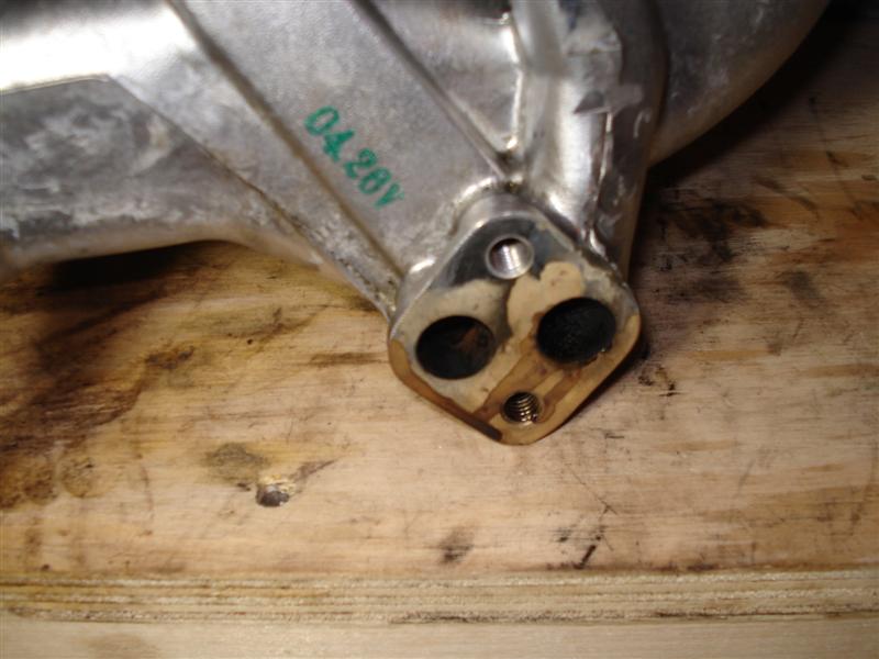

Originally Posted by mrfred
Why would that be? With the EGR solenoid set to 0% duty, there should be no EGR flow.
I think he is refering to the fact that the EGs sit along the #4 runner in the IM. See here:

ok, I see the point, but as long as the gas is not flowing along in that section of tube, there should be very little heat transfer up the tube. I'd say that 90% of the benefit could be had just by zeroing out the EGR duty talbe.
I'll go one better. With no flow through the EGR tube you really will not be able to quantify, realistically speaking, the temp rise. Considering that cylinders 1 and 4 are on the outside perimeter of the engine cylinders 2 and 3 see more temperature related differentials than what you are going to get from an EGR port that isn't actually flowing any exhaust gasses.
