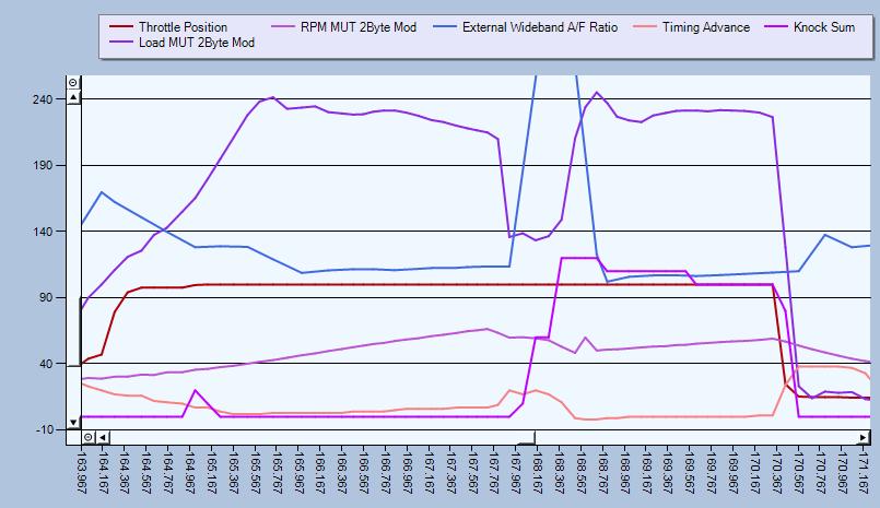

Ive noticed that when i use the NLTS i get some abnormal knock, 12 counts was the max i saw (which based on the engine conditions is to be expected, high boost, no fuel, ~160 load). the problem is the entrance back into power, i came into high load with an afr that was lean off scale then came back to my 12.0 at max boost target and tapers to 11.0 at redline, which is good, but the timing was advanced to like 17 at the entrance to power, which i think is responisble for the knock, ive changed the tables to lower the timing at ~140-180 load and 5000+ rpm (they were the default crusing ones around 18*) now they should help calm that knock down, ill post back tommorow morning (its already beer:30 here)

silver - re nlts test it in the driveway by setting the parameters articially low.. then you will understand how it works.. not sure how many times I have said that.
post up logs of your NLTS knock... and the NLTS not engaging...

Yeah i tried the drive way mode, and i realized the clutch switch is at the very top 1/2 inch of travel. Which i think is good, it cuts power before the clutch is dis-engaged. and doesnt restore power until the clutch is fully engaged. Good design. Here is my screenshot of the knock.I blame the timing.
