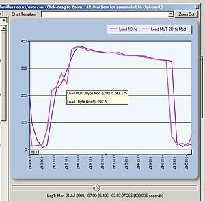

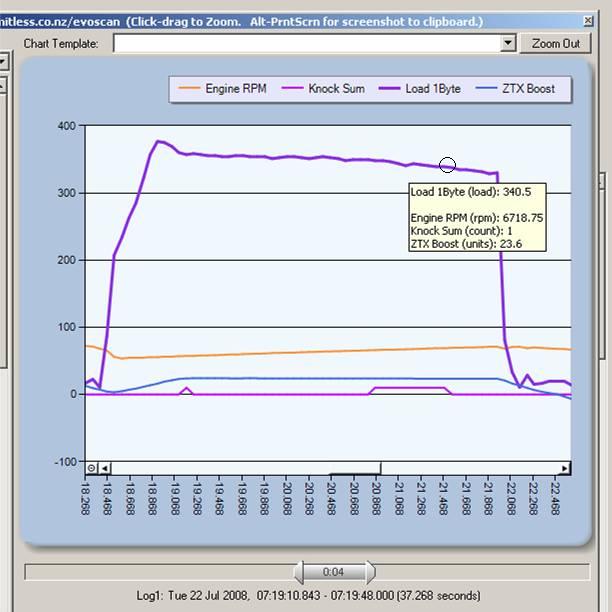

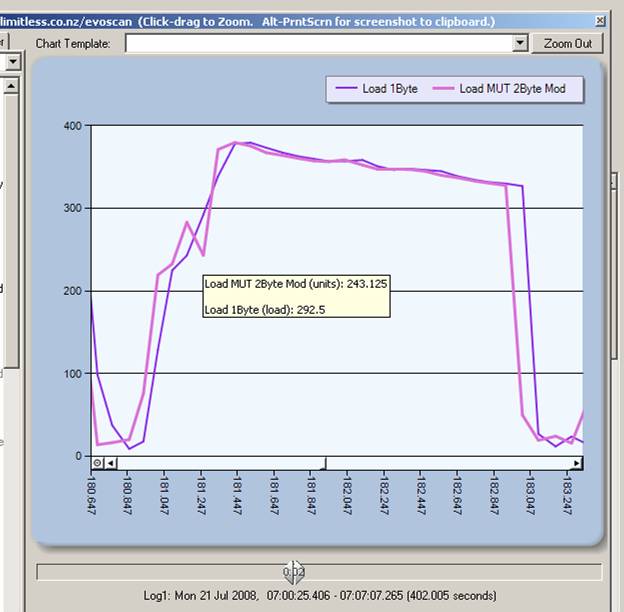

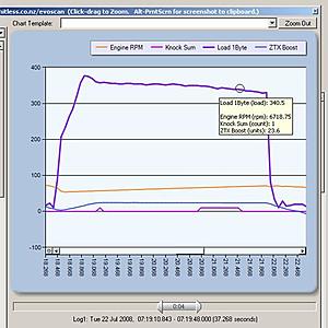

I always get a slight load spike just before peak boost. A few milliseconds later I was at 21.5 psi and 378 load...
This tune's peak numbers should be about 495whp and 405wtq. The 585whp tune was from quite a while ago.
tephra:
Here is a graph that seems to confirm why your 5.8mods have helped on logging load. BTW, why do you think that the 1byte mod line seems to be slightly delayed compared to the 2byte load?
tephra:
