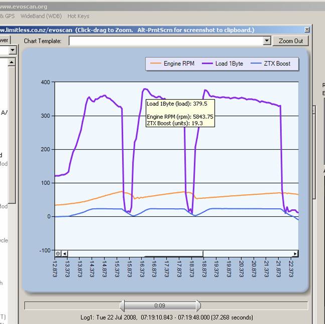

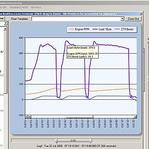

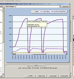

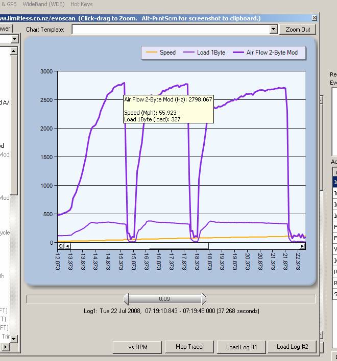

Here is an airflow and 1byte load graph from my way to work this morning:
Attached Thumbnails TephraMOD V5.8 - testing help required-1-byte-load-work.jpg   TephraMOD V5.8 - testing help required-air-flow-work.jpg

379 load with 19psi? Does not compute
Rest of the stuff looks pretty close to what I have seen out of a 2.3L GT35R.
This isn't the tune that made 584whp is it?
