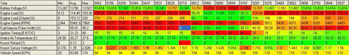

tephra, have problen with nlts
use rom 94170015
when ntls is enabled(no lift to shift = 1) and i change gear on redline rpm with lift i have something like one-two second fuel cut after changing gear(injector pulse=0% in this moment and full thortle(thortle opening=100%))! but when i change gear with out lift(fast shifting) all is normal! any fuel cut
when ntls disabled(no lift to shift = 0) and i change gear on redline with lift i also havn't any fuel cut...
why when ntls enable after change gear with lift(only on hi rpm) i have fuel cut??? help pls
use rom 94170015
move your foot from the clutch petal man
+1, everyone goes thru this lol. If your shoe even REMOTELY is resting on the pedal, the clutch switch is activated and causes fuel cut (the whole point of the NLTS) just get used to FULLY removing your foot between shifts, it takes some getting used to.
most interesting that i hadn't it earlier... it sudenly begins...

yeah - if you are not happy with the engagement/disengagement postion of the clutch you can adjust it - a bit...
another option is to use some foam on the pedal where the swtcih touches.. this increases the throw of the switch...
stil have problem(
have you adjust the pedal?
set your nlts lower and see at what pedal position it switches on to be sure...
otherwise you can put a external switch to the clutch button wire to turn it on/off manually

What are your boost cut tables set to KOTT? Have you removed your throttle body or messed with your TPS at all? If the TPS was the problem the car would just over-rev if it was dis-engaging the NLTS right? The problem is its ENGAGING the NLTS, either that or something else is triggering fuel cut. The boost cut tables are the only thing that realistically would do that other than the NLTS.
