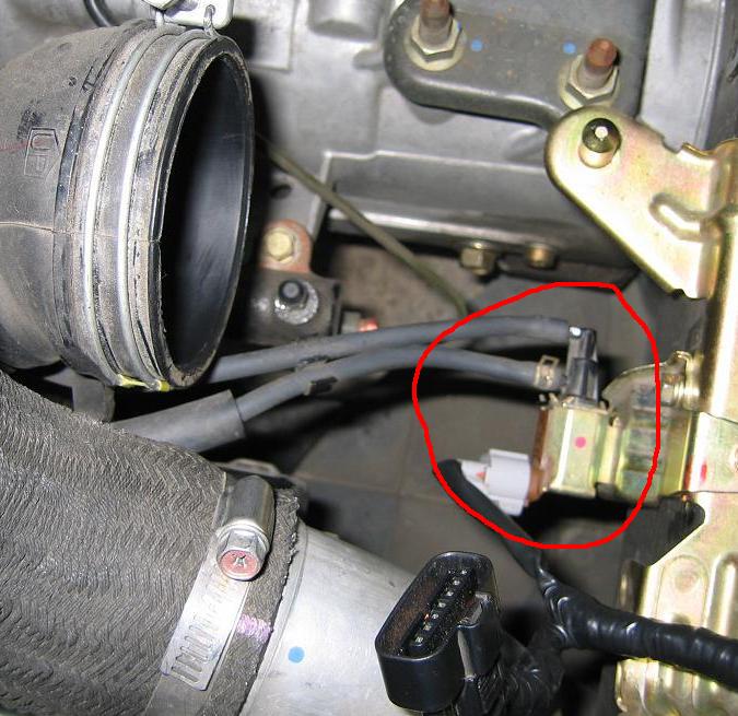

The service engine light has been on for over a week now It first appeared just after starting the car and went to drive out of a car park. It felt like it bogged down more than usual and then bam the light came on. I used scan tech to pull the code and got:
P0105 Manifold Absolute Pressure/Barometric Pressure Circuit Malfunction
I didn't even realise the EDM VIII had a MAP sensor... i've been trying to find a VIII 260 workshop manual, but haven't had much luck.
I have checked the continuity of the wiring from the MAF to the ECU and also what I am guessing is the MAP sensor to ECU.
I searched and couldn't find any info on this code...any help is appreciated

thats the BCS solenoid!

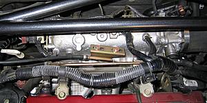

The EDM VIII model doesn't have that location on the intake manifold used...where else could it be??

evoredy's Avatar
Joined: Apr 2008
Posts: 341
From: San Jose, CA
Originally Posted by evl08
Attachment 125615
sorry, i don't know! does the code keep coming back?
anyone else?
EDIT: maybe the MAF went bad???
EDIT2: damn..i knew this..the baro is in the maf. lol. its probably bad if your continuity checks are good.

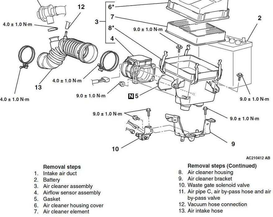

Yeah, the code comes back after I clear it.
I found a manual, only it's not really detailed enough and doesn't mention the baro sensor.
The sensor I pointed out appears to be a wstegate solenoid valve

RazorLab's Avatar
Posts: 14,092
Likes: 1,090
From: Mid-Hudson, NY
Baro sensor is in the MAF.
