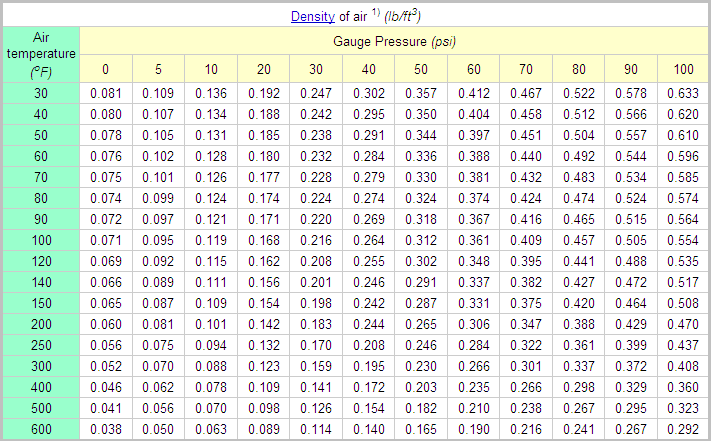

Did some more math though.
Taken from engineering toolbox
*Perhaps a table makes this more clear than equations do.
80F and 15psia =~.149 lb/ft^3
Looking at logs from my pulls and assuming worst case as you've said (10kPa drop):
air temps increasing from 80F up to 110F =~21% density decrease
air pressure decreasing by 10kPa (1.5psi) =~5% density decrease
So over the course of a hot pull I can expect the ECU to see ~26% decrease in air density with temperature having 81% influence.
As you can see, again, I prove that baro is much less significant. It is 4 times less significant. That extra 5% loss in density is far too detailed for this very low-res table to even attempt to compensate for.

Yeah, I hear you. I really was just trying to use the track as an example. What I see as more of an issue is when I tune my car at 32F and then go race a couple months later at 110F. My AFR is not where I want it. It's through the floor. I suppose I should have stated it this way:
I live at sea level. I race at ~650' max.
I may tune at 50F. I may race at 110F.
The difference between when I tune and when I race, considering the above, would be this:
11% decrease in air density due to temp rise.
3% decrease in air density due to static pressure drop.
So what I'm saying is that when temperature is more than 3X more important than baro I would be inclined to ignore baro changes all together. I find it doubtful that many face the situation where their air temp is the same from day to day (unless you're in san fransico) and then the baro change due to intake velocity is more of a concern. I'd be willing to bet that the ECU should be nearly well tuned for that situation. Surely they've taken that into account somewhere. Perhaps the ECU even ignores baro changes in this calc when load exceeds "x" or something like that. Then the x-axis would be merely a function of temp.
I do agree with you though that I find it odd that we can't uncover a dedicated IAT only fuel trim table. There's gotta be one.
