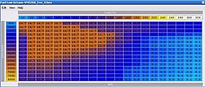

From: DFW, TX
Originally Posted by Slo_crx1
You won't see sub-9's in the true AFR readings, it's only the way that EcuFlash shows the data to appear like an afr table. If you correlated a wideband to that table you'd see that what would appear to be in the 9's afr range would actually be closer to high 10's or so on a wideband. Keep that in mind when the program is released, you wouldn't want to set your tables to what you "think" they should sit at AFR-wise and end up with extremely lean conditions at high boost settings.
I don't understand why it displays it as the AFR then. Does the load just not get to a high enough percentage relative to that graph to hit the 8:1 AFRs? Also I realize it won't be anywhere near the 8000rpm range either. This is the graph I have. I will be tuning once I have a wideband installed to make sure that I'm not going too lean/rich but am just confused why it wouldn't be right on the map I have. Based on the knock maps they peak at 240% load so is that peak load in actuality on the fuel map? That shows 8.8:1 AFR according to the map, does anyone know what the cars actual AFR is then at 7k rpm per a wideband if it's not right around 9:1? Thanks and sorry for all the questions. ~Trent
Attached Thumbnails The definitive EcuFlash Evo 10 thread-low-octane-fuel-map.jpg
The highest loads I hit are around 260 at the highest boost range which is around 3800RPM. By 7000RPM it's usually in the 200-210 range.
One thing you have to remember about the fuel map is that it does not display real AFR values. If you see the map reading 11.1:1, it will not be 11.1:1 on a wideband most of the time. In my case, if my map reads 11.1:1, it'll usually read around 10.5:1 on a wideband, the actual values are richer for me than what is represented on the map. This may not always be the same for everyone, it can vary due to mods, climate, elevation, etc. The only way to see your actual values are to hook up a wideband.
Based on whp figures, a stock 10 ought to be hitting about 220-240 load at around 3500 rpm and then tappering down to around 180 load at 7000 rpm.
At any rate, there are many factors (e.g., engine temp, air temp, barometric pressure, VE, etc) that must be accounted for by the ECU program when converting an AFR value in a table into a fuel pulse width. Its very difficult for the ECU programmers to to get the actual AFR to match the table AFR over the full range of RPM and load. There's always some difference. That's why its imperative to tune using a WB O2 sensor.
