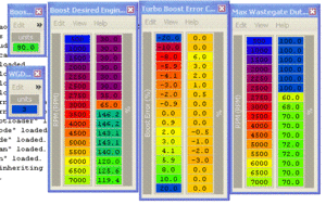

i just installed a 3port GM Boost Selenoid, this is on a stock turbo VIII. i need to set the boost to 22psi as how it was set on my MBC, can you show me your boost setting for 22 psi that i can use to start with

but it would be a lot easier if I can use someones boost maps, and adjust from there, cause coming from a MBC my maps are all set to 0

This gave me about 21-22 PSi at around 70 degrees. The temperature has been raising hell and overboosting in the cold, though. The BCLO and MWGDC are pretty good. Keep in mind every car will be different, sometimes wildly so.
Attached Thumbnails 22 psi Boost setting for stock turbo-boost-control-tables.gif
