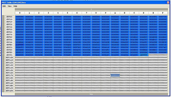

From: MIA
anyone have a better xml definition for 53040007? For one the MUT table in mine doesn't quite look correct. below are links to the xml and rom i'm working with..thanks!
http://65.18.174.69/e6/tuning/53040007.xml
http://65.18.174.69/e6/tuning/EDM10RS.zip
Old Jul 11, 2009 | 02:26 PM
  #535
Bob_tm's Avatar
Joined: Oct 2008
Posts: 126
From: Ukraine
<table name="MUT Table" address="3e320">
<table name="X"/>
<table name="Y"/>
</table>

thank you sir!
<table name="X"/>
<table name="Y"/>
</table>
