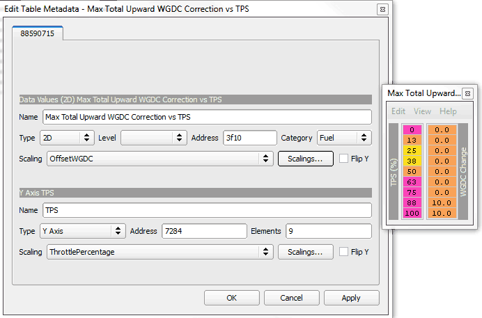

Originally Posted by PeteyTurbo@KHC
Values they are set to..This is what I have for tps axis:
70.5882
10139.2
25660.8
70.5882
10139.2
25660.8
Also this car is not reacting well to this rom but I am going to clean out my xml's and try a fresh one.
Flash car> car will not start(cranks)>flash back tune before applying 0-100 tps scaling>then flash tune that prevents car from starting>car fires right up>wait 10 min and start again=car will not start lol....I also believe I had the map sensor scaling set for jdm 3 bar for the target boost table but I doubt it would prevent the car from starting.. Probably something in the xml or wgdc TPS but I will post up what I find to be the problem.
Did you ever find out what was causing this problem? I have that same y-axis values messed up problem. My car also will not start after I flash the car, run it.. and turn it off for a minute. I'm using the OMNI 4Bar with omni settings in place.
Old Mar 20, 2011 | 07:12 PM
  #2205
Raptord's Avatar
Joined: Mar 2009
Posts: 3,525
Likes: 20
This is what your table def. should look like for max upward tps correction:
