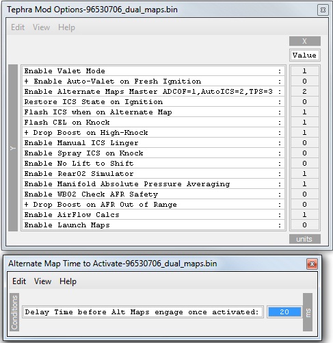

Noob question sorry. I'm trying to use dual maps on v7 and can't seem to get back to the main map once I've enabled the Alt Map (via AutoICS). The ICS just keeps flashing no matter how often (or long) I hold down the button!
Everything I've read says you "hold down the "Auto ICS" button for a predefined period of time" to toggle between maps. What is this predefined period? Is that the 'Alternate Map Time to Activate'? Mine is set to 20ms - perhaps this is too short?
Settings attached.
Settings attached.
Attachment 165184
That's way too short. Set it to 2000ms (= 2seconds) or something like that.

^ Cheers Raptord. Will try that.
I had to flash my ECU just to get it off the alt map yesterday
