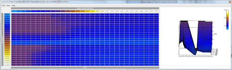

you need to try and smooth out the transitions between the areas too,

Originally Posted by Seijuro
I noticed nobody commented on this. I see the same thing. Is this normal?
If so, does everybody just make the knock decay timer really short to compensate?
NO...do nothing to your knock sensor tables.
Couple of things can be happening to cause this. If it's real knock, it could be because of a overly rich condition(which can and will cause knock) or because of inconsistant/non-smoothed timing curve. It can also be phantom knock from something banging around in and around the engine or even valve train noise/mechanical noise.
I suggest you log AFR's during a 2-step (before and after) and adjust AFR's no richer than about 10.0:1 during the 2-step and in the low 11's during spool up. You want some extra fuel in there, but not too much that it can cause knock, while remaining safe. Once you get AFRs dialed in, look at timing and smooth out the transitions (to and from launch maps and main maps) as well as the timing curve in your launch maps. Be sure to look at a map-trace so you can see what cells your ECU is polling during a launch. You will need to re-adjust fuel when you make timing changes, so as you make the timing changes, don't forget to re-adjust your AFRs.
Old Mar 27, 2010 | 07:44 AM
  #87
Seijuro's Avatar
Joined: Aug 2009
Posts: 128
From: Herndon, VA
It could be because I'm going too rich, I think I'll revisit this after I get my MAF set right.
These are the tables I was using. Stationary rev limit is @ 5500.
Click for bigger.
Click for Bigger.
