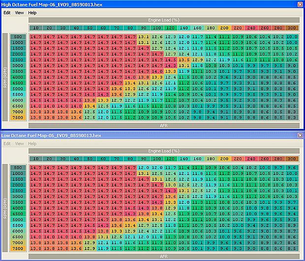

I was about to start a thread about the Evo9 maps, before I saw this thread.
I'm trying to use the 9 maps in a earlier rom, but am a little confused.
The Evo9 LowOct map is richer at low rpms, but leaner at high rpms.
Is this for EGTs like stated ealier, or is there another explanation?
Are tuned maps usually the same way? Or do they make everything richer?

Drive around with an unplugged MAF and it will be at 1-2*. Believe it or not it drives pretty well. That being said I think that is in an imaginary number becuase I have never logged anything remotely close to -30 timing pull.
