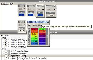

So I figured a pic is worth a thousand words.
When I was logging the only value that would ever show up for the IPW was 1.024. Even after changing and flashing the map. Now I wend all the way down to ~.9 and that just made the car super crazy. When running 1.128 it seemed that the car was pretty stable, very rich 12-13's but pretty stable. If I bumped it back down to 1.024 it would be in the 13-17's range, but it would see a lot of 14-15's in there.
When you would tap on the throttle from a stop it would have a lot of hesitation. Now I am currently on 91oct here in cali.

right so
@ 1.024 you get wild swings
@ 1.128 you get good idle, but too rich
try 1.076
