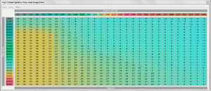

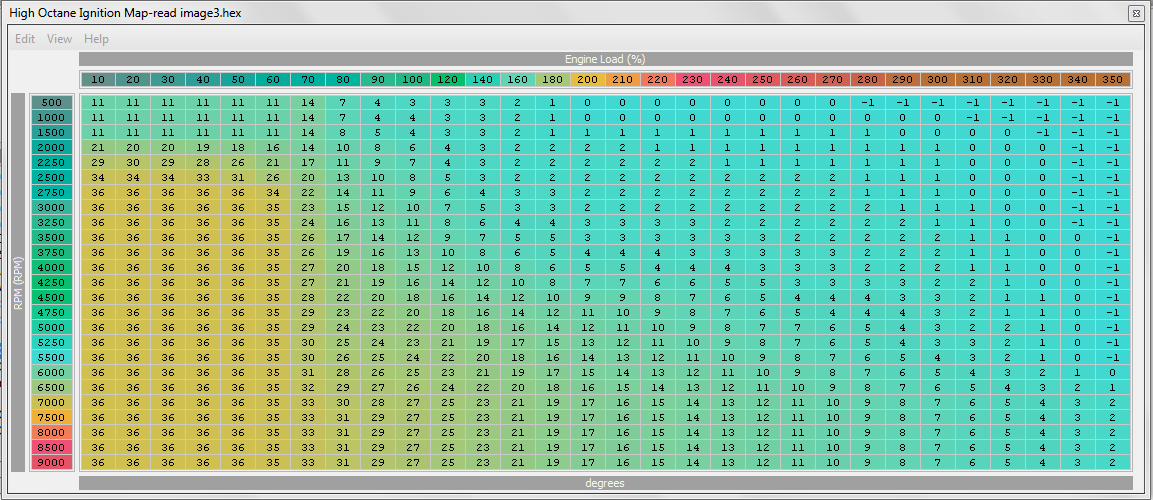

yes, she is quiet to the ear, I bled them.. i had kind of discovered a "no way its that problem so I wont even try" type of mistake. Skunk2 manifold hogged out by STM + s2 cams.
this is pretty close to all knock gone now. I had taken out too much timing. Im still getting some low load knock, and im trying to compare my hks + stock mani map vs my s2 + s2 map.. and well things arent even close. Im kinda shootin in the dark 200 load all the way! I havent boosted above wastegate yet.
I kind of feel that Im lacking timing seriously, but i think that with a substantial increase in airflow ability that im moving in the right direction.

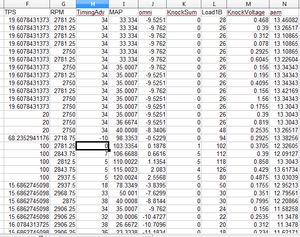

is my timing way the hell off here or something? I have tried a lot of things, and I cannot get this light throttle knock to go away!

Im not seeing any difference in taking some overlap out. Im seeing cts of 34. this has got to be false.. Doing a ton of research.
I wonder if my Dynomax vt muffler is rattling and causing a bit of the false knock.

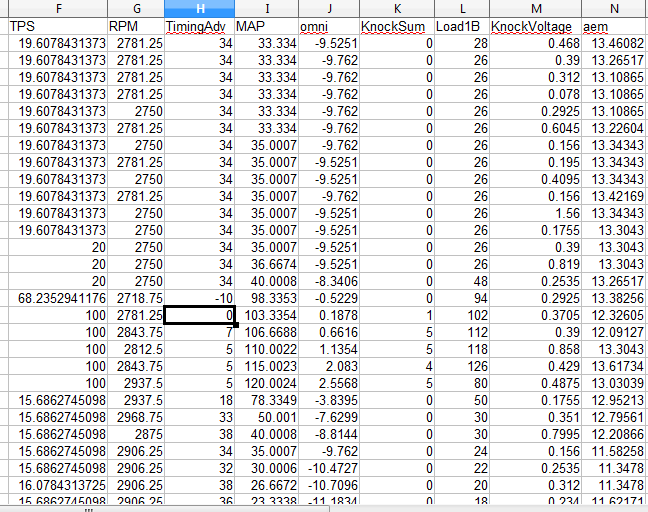

i normally get a -10 like this, and i dont know where it comes from

that timing jump 34,-10,0,7 seems wierd to me
can induce knock I think

Do you see the same timing drop on a normal non-als rom? Just wondering of some of the timing mods you've done may be messing things up.

Im on a usdm rom atm.. with no negative timing

Do you think the -10 is a result of the load spike/jitter? Try logging only load and rpm and see if you see the spike. Is the highest load for that rpm set to -10 deg timing? It seems very similar to what I remember experiencing with the 3d ve 9653 rom. But I wasnt seeing it during a pull, only cruising.
