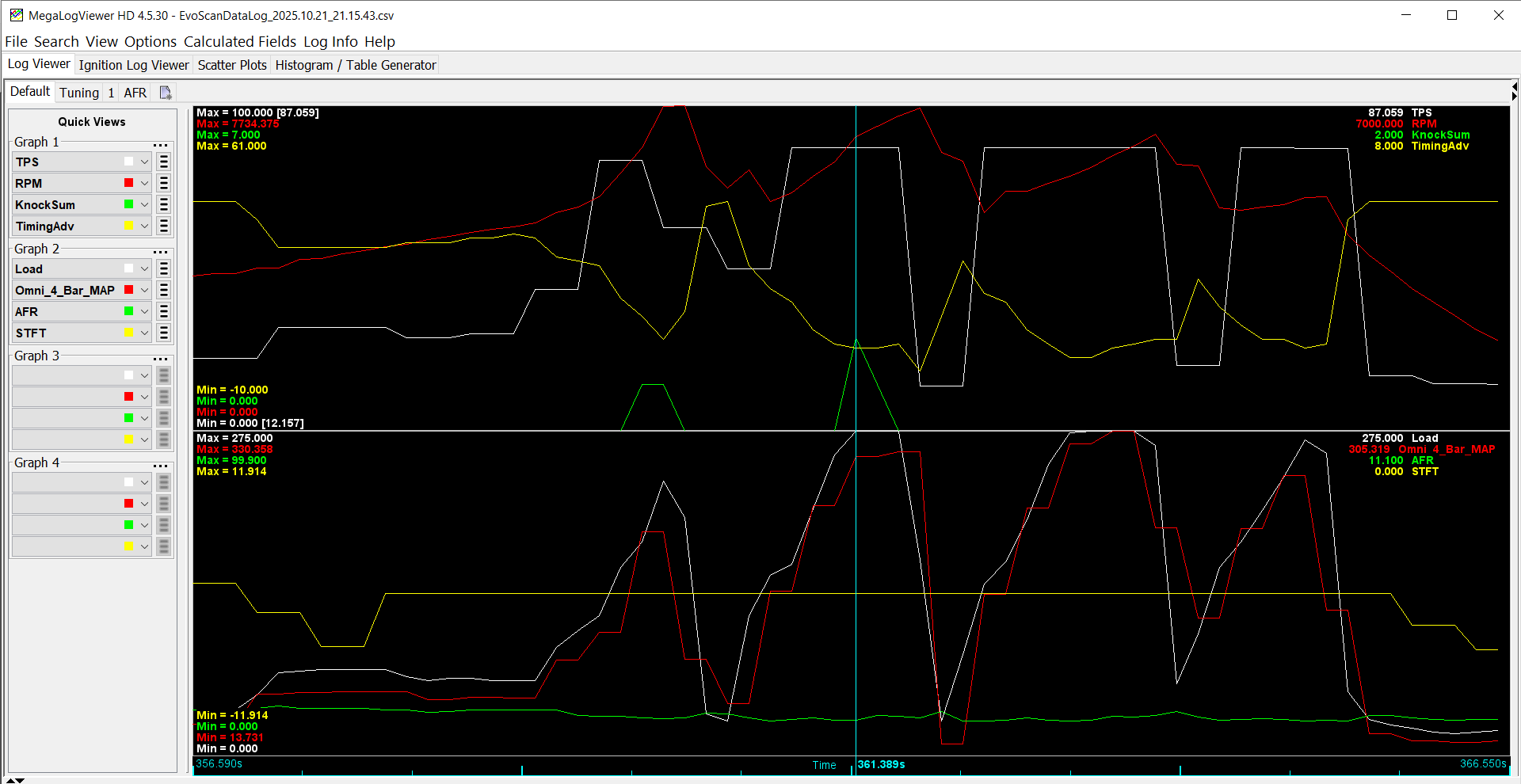

Hello,
I have knock at spool, what is a tune strategy for evo x?
Note: forged piston and rod, PTE 6466, ID2000
Thanks

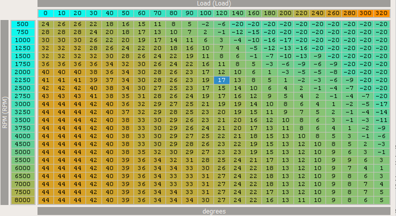

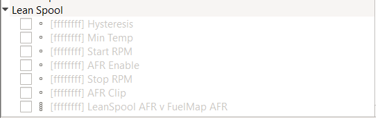

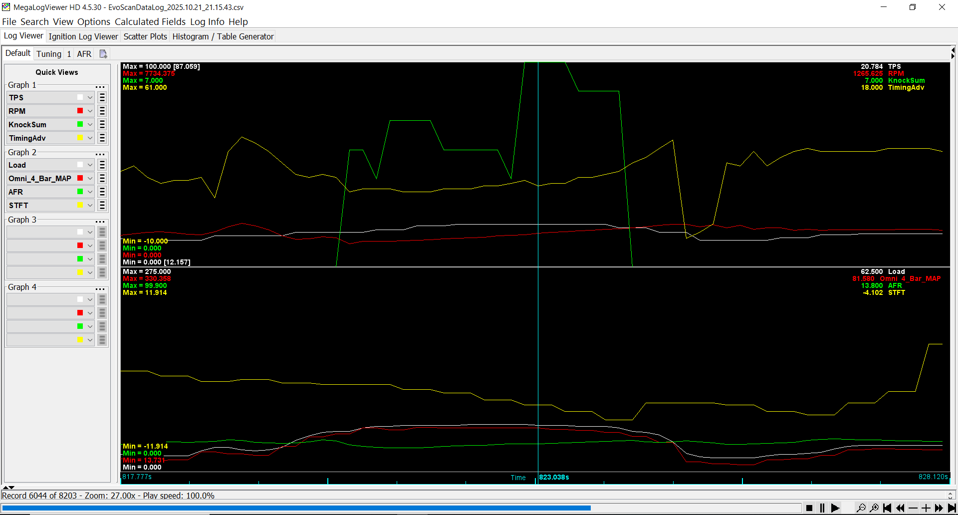

Is lean spool on or off?
Have you pulled timing in the tables in advance is see if it STILL tries to pull timing?
What is the AFR during these spool knock events?
Is throttle WOT when it occurs, and does it occur at throttle % less than WOT?

Another issue: some time I have knock at cruse maybe my clutch making noise because twin clutch (tilton twin clutch).
Cruse: 1 to 7 degree
WOT:
Lean spool not available in my XDF: 58010005

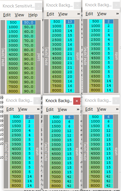

You should not be able to get knock at cruise. There is a table called Knock Sensitivity Load Threshold that basically says "if the load is less than this, ignore the knock sensor". I am curious what yours has in there!!!
Great, your answer helpful.
What about "Knock Background Noise Multiplier" and "Knock Background Noise Adder (SINGLE GAIN) #1" can you explain it?
