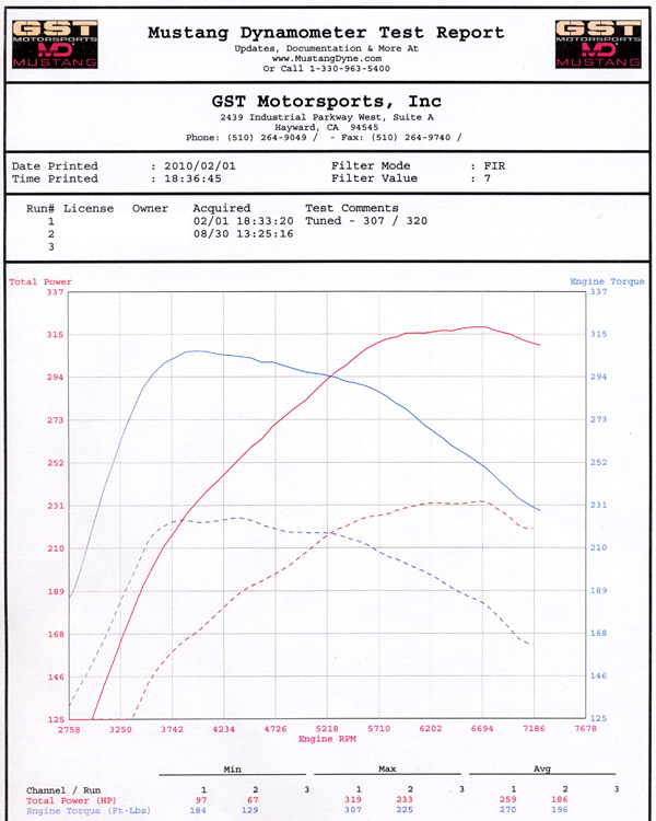

Evo 9 MR SE from stock to +100 whp
2006 Evo 9 MR SE
Mods:
Works Downpipe
Test Pipe
Perrin Catback
Perrin 3 port Boost Solenoid @ 24 psi peak
AEM Intake
Nisei LICP/UICP
Walbro fuel pump
Stock FMIC
Stock Cams
Stock 02 housing
No porting
Custom GST dyno tuning using EcuFlash w/ Tephra V7 rom
This car made really really good power for our dyno on stock cams, etc. The 91 oct stock turbo dyno record that has been held for 3 years now is 339 whp so for this to get even 20 within with MUCH less mods is pretty darn good. She's a strong one!
Could have made a little more power with more boost up top but the car ran out of injectors.
319 whp / 307 wtq
+ 100 whp gains up top from stock
Dotted is 100% stock baseline with no parts and stock factory tune.
For reference on our dyno:
Stock 03/04 evo = 190-210whp
Stock 05 evo = 210-215whp
Stock 06 evo = 220-230whp
Stock 08 evo = 215-230whp
Stock 09 Ralliart = 190-199whp

So mods plus tune = 100whp??? Good work, the car definitely has a strong motor!

Holy crap! That's huge power for those mods...usually the stock fmic wont let you run enough boost with a bcs to make more power, not to mention the 91.....damn....sure there isnt a 5- or 7-blade wheel under that intake?

Not on this dyno.

Nice work Bryan.. Your dyno does prove to read very low.. Essential to have before and after pulls on the car for sure to show the +100whp.. Awesome!!
