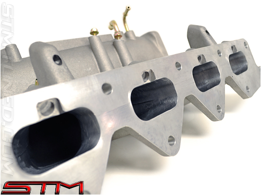

Those runners seriously need work... I remember you had to seriously watch the skunk2 honda manifolds as there was tons of crap that had to be cleaned up in the manifold...
You are not kidding! I think there is going to be between two and three hours of port work needed.

Ours also came in and I agree, it could benefit from some fairly substantial porting. Ours is getting cleaned out and ported also. Emery, I'm going to call you, I see some other issues before you put it on....

Thats pretty odd. The ones we have here have no step in them.
If thats the case then yours probably do not match the head ports as they are put there to make them match. The cast is off for sure and that is their fix.
-Em
Gasket matched perfect. I didn't check all the ones we have but the last two i checked were that way.
So they must have two different casts then? Because without the port work they did it would be a mile off.
-Em
Not to sure. I got mine direct from Skunk. I am gonna talk to Tony from Skunk about it and let you guys know.

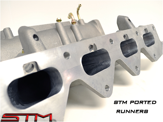

So far we have found a bunch of things that need to be changed to make this thing work. Not a problem though, As long as it works when installed we will fix the issues and do the port work on all of them we sell.
Here are a few pics of the runners cleaned up.
-Em

Do you think the sharp edges by the injector provision should be smoothed out as well to aide with atomization, or will it not be effected?
Most, if not all of the Evo injectors have sort of a bell at the end on them that protrudes into the manifold a ways making the edges no issue.
We are bolting it on now. Its been a few hour fight getting it ready. I really hope this works.
-Em

Nice looking ports there, in for results.
-Em
Gotcha, didn't know if the tips extended past that portion of the manifold or not...
