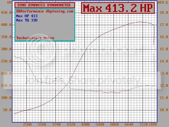

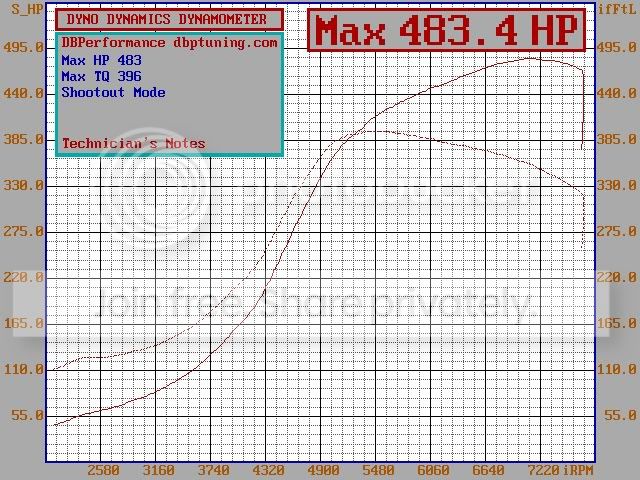

Correct me if I'm wrong, Shoudn't you be making more? I'm got mine dyno tune on a dyno dynamics and making 413whp/338TQ. But my setup is ATP GT3071R w/ Tial 38mm WG.
HP VS TQ
HP VS AFR
HP VS PSI
Shootout mode
