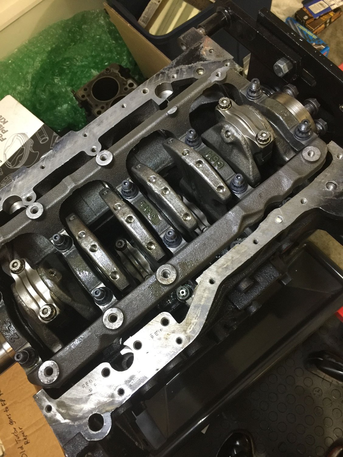

We have just recently completed our good customer Anthony's Full Build. This vehicle is special, Because the owner is active Military & the vehicle visits Germany's famous Road course track.
(Thank you for your services Anthony!). This vehicle has been around the famous Nurburgring in Germany many times in the past, and will be going around it again with our build. When we received this car, it had an issue where it burned a lot of oil & had piston slap, so it needed machine work + new pistons and bearings. Along the way, we refreshed what we thought was necessary to extract a reliable build for our customers car.
After the build was completed, We thoroughly broke the engine in. We go through 3-4 oil changes & filters before the customer receives their car back. This assures the engine was properly flushed and is safe for long term use.
Temps during tuning were roughly around 40-45F.
93 octane was done with E9-10 mix.
E85 tune was done with E62-64 mix
If you're in the market for a very reliable tune and engine build package or want us to perform a full build on your car please contact us! We have 3 more builds being finished up and will be shared as well after this one. All with FiTronic!

Side notes: With a better BOV such as a tial Q, and a short route upper pipe to go along with it (Such as Muse), And Stronger wastegate actuator, (Car is using OEM), We would of been able to extract a lot more power out of this beast! We did what we could with the boost falling off hard, and still extracted a pretty solid result. The car spun 2nd hard, So the CBRD BBK 3B delivers a very nice kick downlow complimented by our 2.3L Engine.
