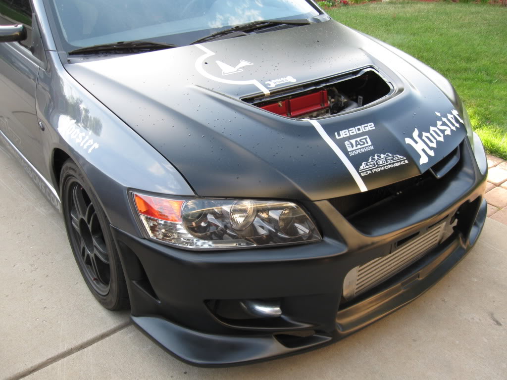

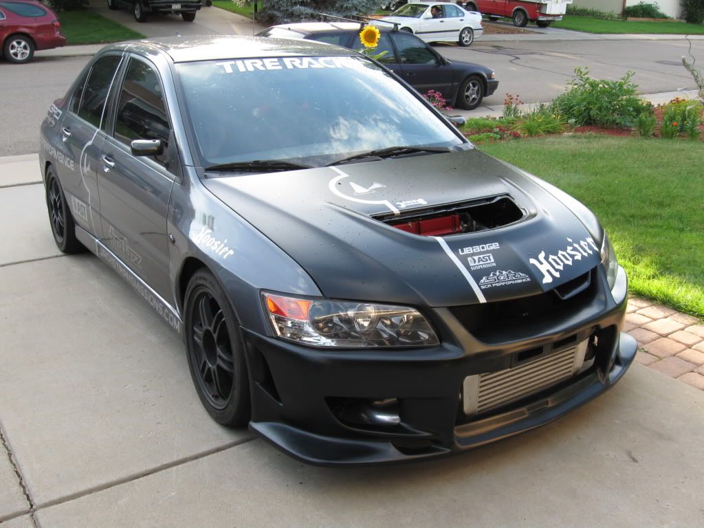

Can't help you on the USDM OEM rear bumper cover vs. the JDM one, but I did weight my OEM Evo9 front bumper cover (with the OEM SE urethane lip) because as an autocrosser, I want as much weight off the nose of the car as possible.
Evo 9 SE front bumper cover w lip (urethane), steel bracket & hardware for securing central mesh removed – 16.30 lb.
C-West replica Evo bumper cover (fiberglas) mesh inserts removed, before paint – 12.25 lb.
After I installed it, I carved out some of the fiberglas material underneath to save more weight, but added it back on with paint. But still, over 4 pounds off the very farthest forward point of the car is a significant improvement.
Here are the exact numbers:
OEM Evo9 urethane bumper cover and SE lip: 16.30 lb.
Original weight of C-west replica bumper cover, before I did anything to it: 12.25 lb.
C-west bumper cover after modifying it to fit over the OEM bumper beam, and cutting out as much fiberglas as I felt wouldn't weaken it: 11.23 lb.
After painting (one can of primer, and FIVE cans of paint): 11.71 lb.
Two aluminum braces/bolts I asian-eered to create a little more tire/fender clearance and hopefully keep the bumper cover from cracking when I hit cones during autocross events: .21 lb.
TOTAL WEIGHT SAVINGS: 16.3 - 11.71 = 4.59 saved, but + .21 for bracing = 4.38 lb
Lighter after I cut stuff out:
The bits I cut out (.89 lb):
After spraypainting it, installed:
