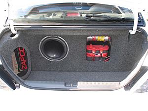

my pics that I have online right now... I'l post more better ones later.
the setup:
eclipse 8053
focal polyglass 6.5 components
JL 12w6v2
2 zapco amps.
optima redtop
zapco simiblink balanced line drivers (no RCA cables in this system)
it's an SQ setup but can still hit about 130db.

I would never do that since I need some trunk space but prop to you!
The amp on the side looks great !

I guess it all depends on how much space you need.
I still have the spare tire and can fit a couple suitcases or a bag of golf clubs. anything beyond that just goes on the rear seat.
