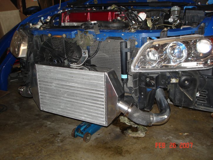

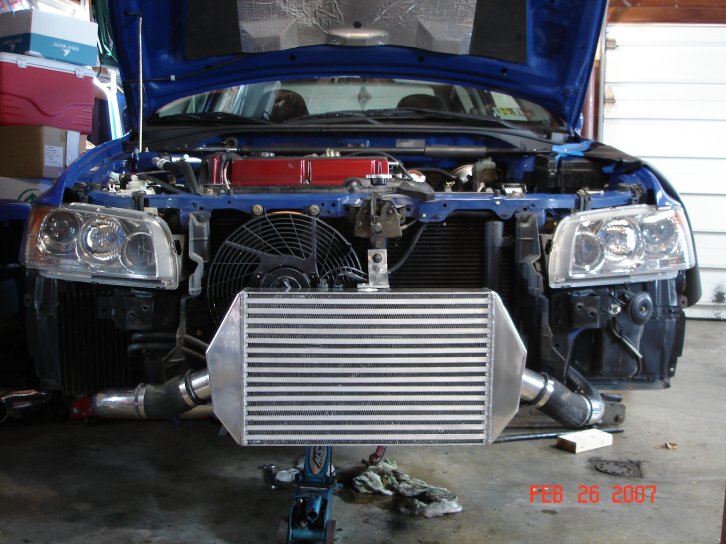

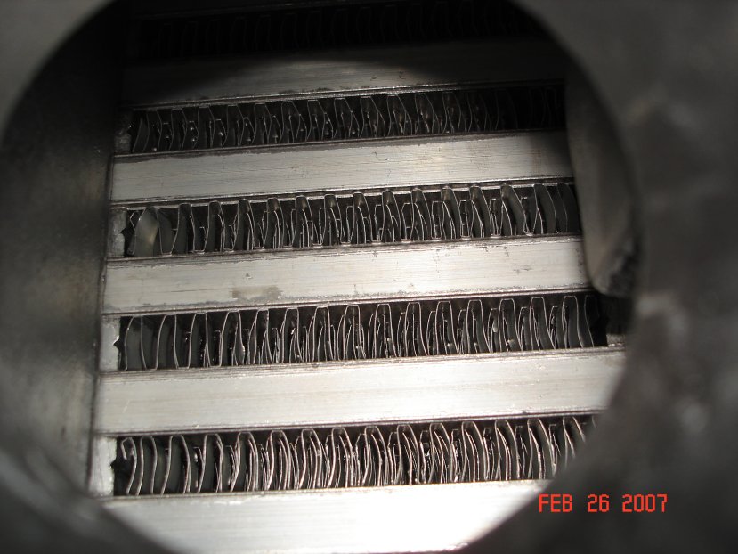

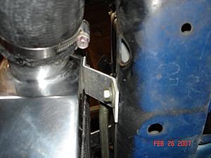

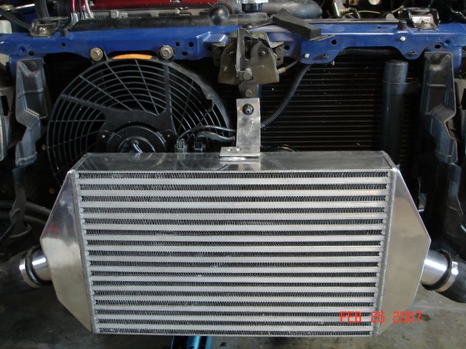

after reading Buschur's post about cleaning the inside of the IC, i decided to do mine and got a chance to take some more pics. when i did the original post, i didn't know there was going to be a much headed debate about this IC, so here are some more pics to clear up some misconceptions.
i also weight the IC and it turned out to be 22 lbs with the backets on.
the front view

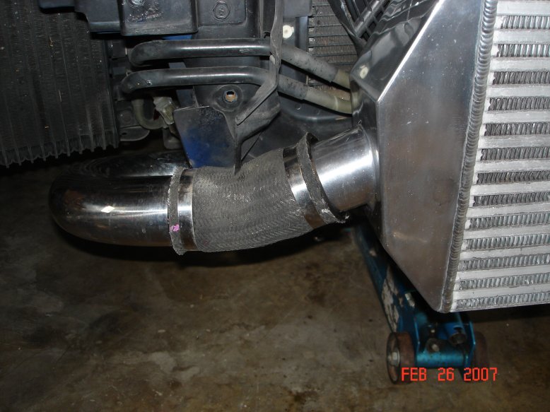

driver side hose
passenger side hose. notice that on both side, the hose have to be straighten a little. this is where most people have the problem. but notice there are no kinks in the hose.
top bracket
bottom bracket

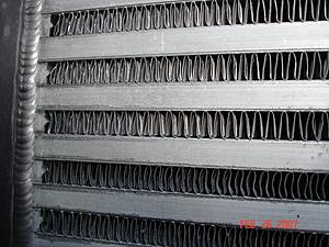

the welds, not bad for a 12 years old kid, huh. not a perfect roll of coins but good enough to keep the boost in.
outside cooling fins

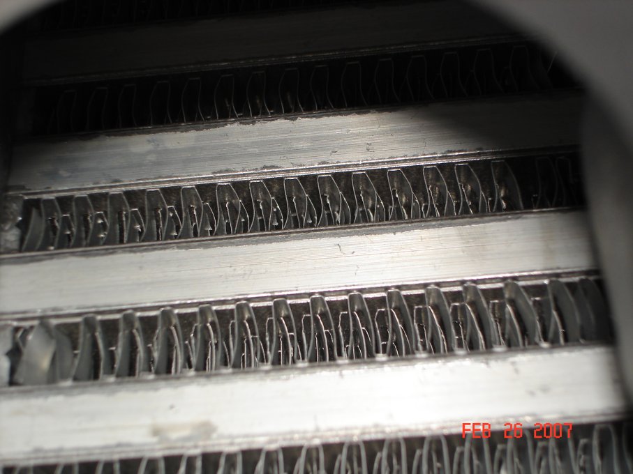

inside cooling fins
another shot of the inside cooling fins. some of the inside fins are bent because i was using compressed air to dry out the IC after i cleaned it.
Attached Thumbnails installed my XSPower intercooler this week-1.jpg   installed my XSPower intercooler this week-2.jpg   installed my XSPower intercooler this week-3.jpg   installed my XSPower intercooler this week-4.jpg   installed my XSPower intercooler this week-5.jpg

more pics.

we need to start a donation fund to get honda-guy a set of jackstands before we see him as a headline story on the news.
Old Feb 26, 2007 | 10:08 AM
  #218
whitersevo's Avatar
Joined: May 2006
Posts: 1,082
From: Arizona, FTW
^^^^^ wow that isnt very safe.
hey, i could aways use a donation.
all jokes aside, i do have two jack stand under the car, each next to the jack on each side (you just can't see it in the pics). the front jack is holding up the engine since the tranny is. i try to be very cautious when working under the car or when the engine is running. i witness my friend lost a finger when the glove got pulled in by the timing belt and crushed his fingers. i had to drive him to the hospital.
edit: you can see part of the jack stand leg on the first pics next to the passenger side jack. oh, and the rear wheels are on ramps with the ebrake on.
