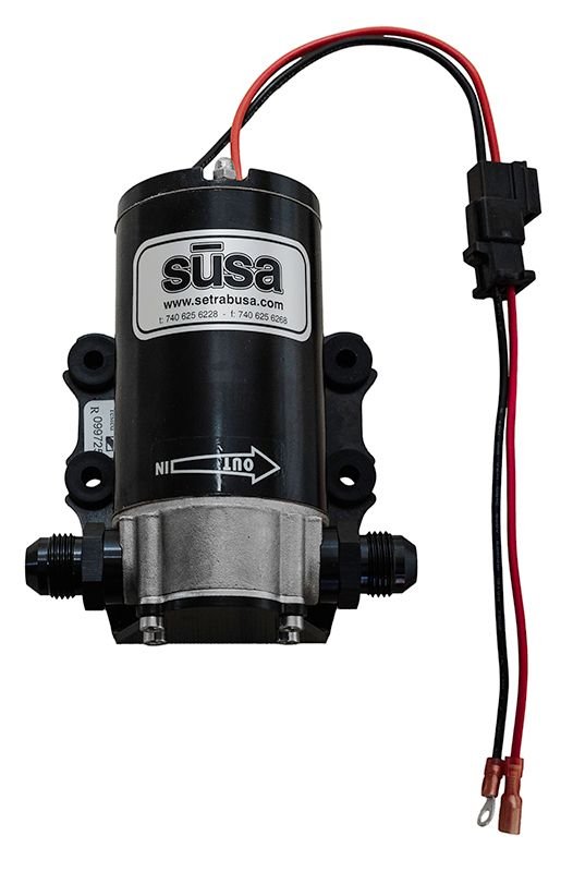

i am going with this pump, smaller than the Tilton
http://www.setrabusa.com/products/oilcontrol/pumps/

I found it cheaper from a Porsche racing part dealer....but i had to get it as a package (oil cooler and fittings)
But the Setrab pump looks just like this MOCAL
