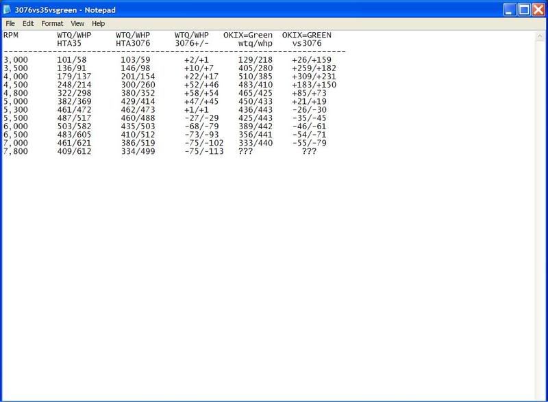

Since there were a few questions as to comparing the HTA3076 to the OKIX Green, here you go. DB, I hope you don't mind me posting these, but it's a good comparison since ours was also run on your dyno. Differences are, we used Import vs C16; we had max psi set at 37 vs 31.5 psi; and the obvious diff. car,weights,temp, etc, but both running a 2.0 Buschur Stage 3 motor, ours with a cast manifold but same Intake/TB, we run JUN272's vs Buschur 272BFC's. This data is not to say look at ours or anything even close to that. It's to take a known car/engine/results (OKIX) and compare it to a new turbo. Very close similarties however. Hope the data is useful. I think it points out why David has said many times, the Green is a hard turbo to beat. I think the 3076 has tremendous potential, but the Green is a lowend torque monster with high enough boost.
edited because wtq/whp numbers were compared in reverse: working on remake.
The Following is a CORRECTED TABLE:

Wow you put more power at higher rpms than the hta3076 but are down in torque by over 150lb ft. How did that happen?
Also the gains seem bigger for the hta 3076 when put down in numbers versus a graph. Its a substantial improvement to 5000rpms. But the ultimate power the 35r can make is so appealing.
