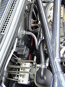

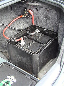

Used a Summit Racing sealed battery box kit. Came with 1 guage cable and all hardware, cost around $100. Also installed a circuit breaker in the trunk. Made a cover for the distrbution under the hood and mounted it on a brake resivior mount. Install difficulty: easy. I just don't trust those little batteries.My Battery Relocation-dsc00350.jpg

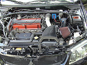

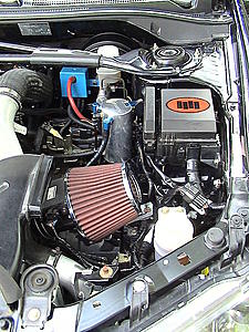

This is mine:

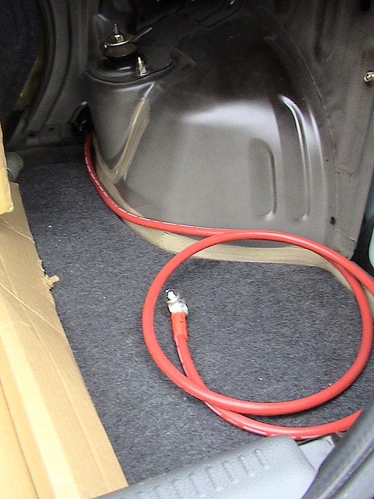

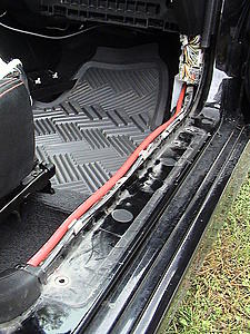

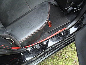

Yes, the negatve cable is to short, just grounded it to the most convienent place till I get longer cable. The positive cable runs down by the backseat, (just pop out the bottom seat section). Run cable along where stock wiring is under door sills, feed through opening on passenger side firewall,, near top by the strut mount. It's 1 gauge cable , but was easy to work with and fit under the door trim. My Battery Relocation-dsc00164.jpg

What size circuit breaker was used with your battery? The one mounted right next to it?
